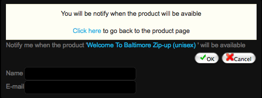

I recently upgraded to HikaShop 1.6.0 Essential mainly for its wish list functionality. I am running into major issues with the wish list feature, it is not functioning at all. Plugins and modules are enabled.

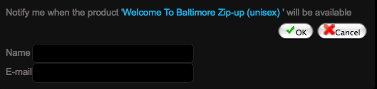

Although the "notify me when available" button is present, the secondary wish list window only offers name and email without any variants.
There are no save chosen product variants / options.
There is no ability for customer to view / edit / delete / move to basket / copy to basket
There are no wish list basket options or customer comments field.

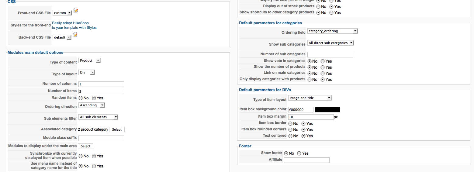

I think that you have some configuration problems, can you give me some screenshots of your configuration ?

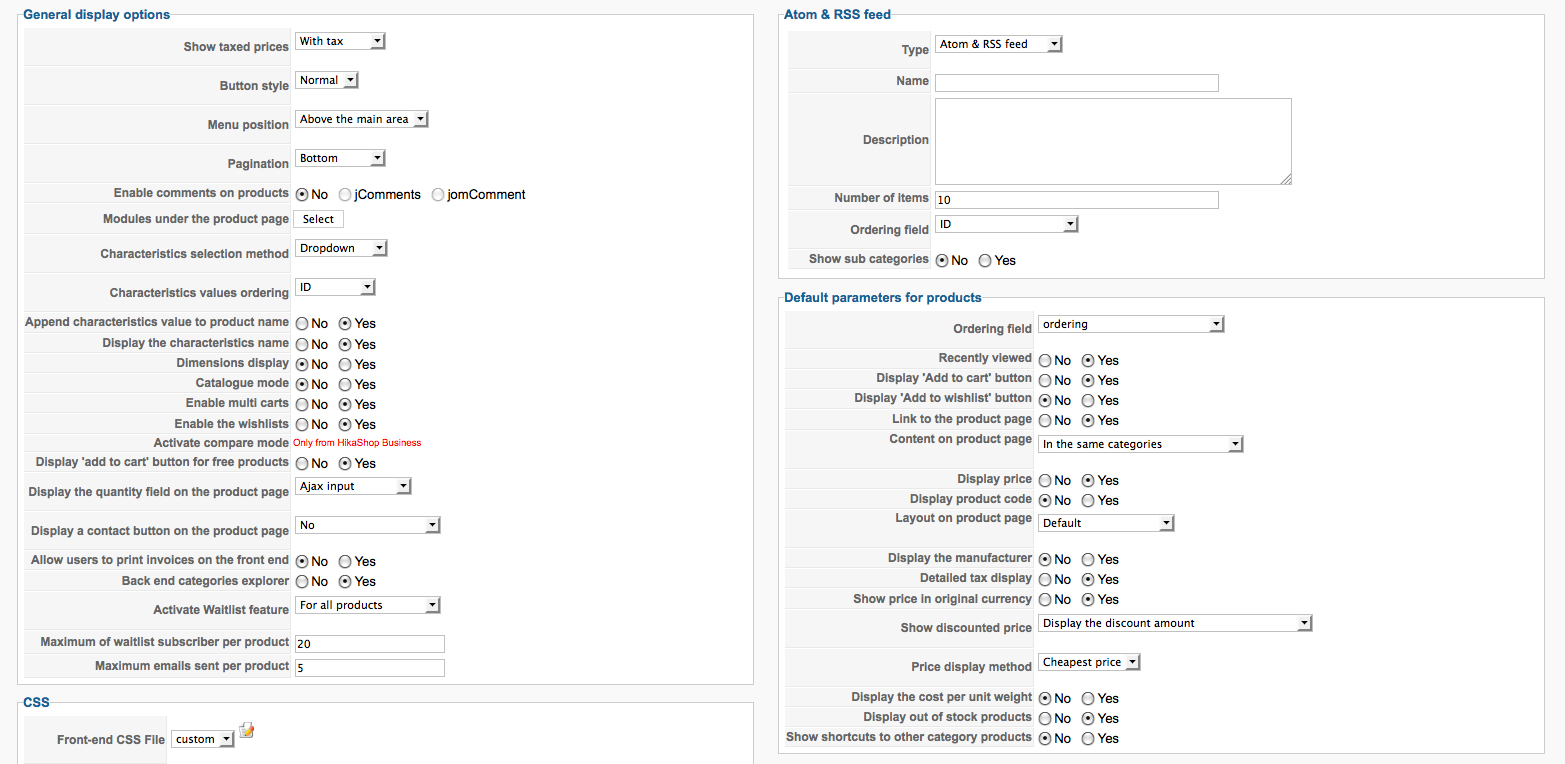

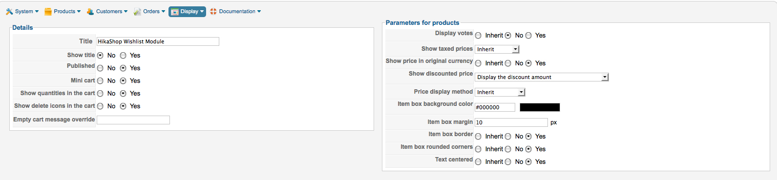

Here are some screenshots of the configuration;
The secondary wish list is just the panel that appears after the add to wish list button is activated. In this window/panel there are no choices to choose product variants such as color, size, etc.
The wish list cart/module remains empty.

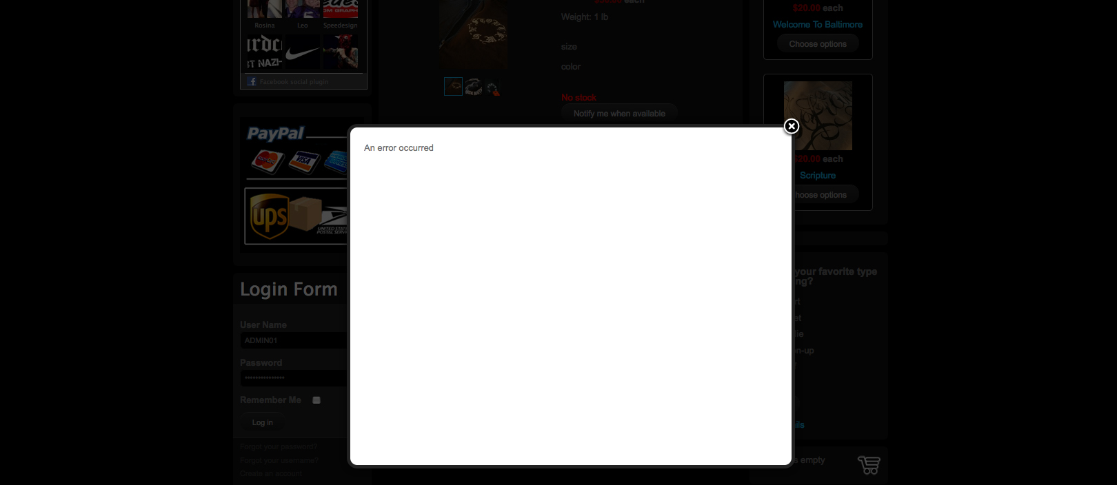

Also error screen produced carries a line of code.
product/116-welcome-to-baltimore-zip-up-unisex-span-class-hikashop-product-variant-subname-black-s-span#

First of all, can you try to install the last release from our site hikashop.com ? Because the "an error occured" message in the popup notice has been corrected since the last release.

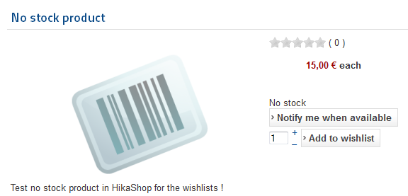

I tried your configuration on my end, and it's working fine.
The "add to wishlist" button appear on the product page, and not on the waitlist subscription page, look at this screenshot:
Hope this will help you.

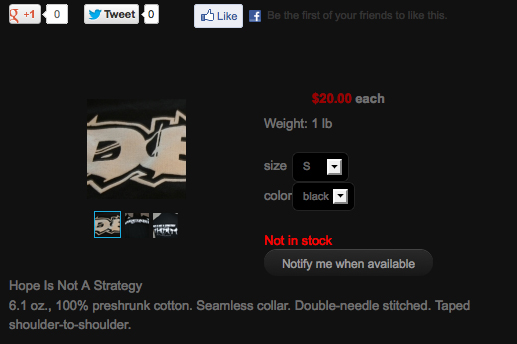

The "add to wishlist" button dose not appear on my product page although the "Notify me when available" button dose.
example in screen shot.
The waitlist subscription page also remains blank as dose the wishlist module.

I triple checked the configuration and enabled the "Add to wishlist" button under "Default parameters for products" after which I ran into a error code.
Fatal error: Call to a member function displayButton() on a non-object in /home/seekwith/public_html/components/com_hikashop/views/product/tmpl/quantity.php on line 18
I edit the file "product / quantity" in HikaShop > Display > View.
Placing the code within the php tag.
<?php
if(!isset($this->cart))
$this->cart = hikashop_get('helper.cart');
Now everything looks to be working fine.
Thank you
