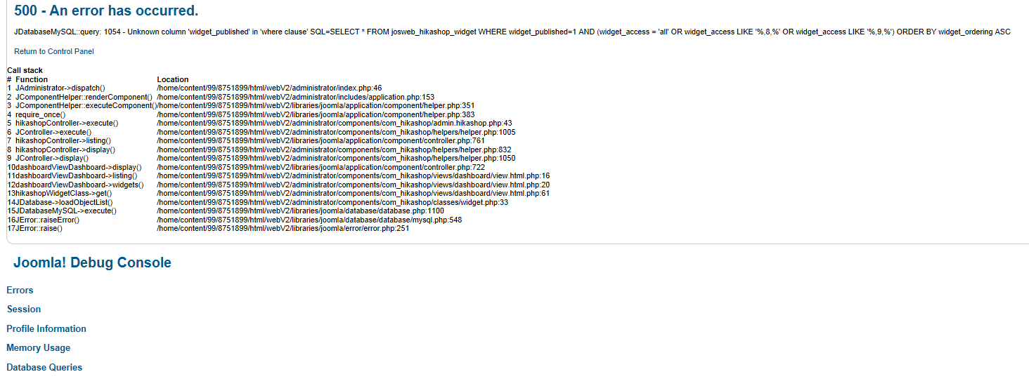

Issue is when I download the zip file "com_hikashop_business_1.6.0_2012-09-28" and try to install via Extension Manager, thats when the failure starts.
500 - An error has occurred.
JDatabaseMySQL::query: 1060 - Duplicate column name 'cart_type' SQL=ALTER TABLE `josweb_hikashop_cart` ADD `cart_type` varchar(25) NOT NULL DEFAULT 'cart', ADD `cart_name` varchar(50) NOT NULL, ADD `cart_share` varchar(255) NOT NULL DEFAULT 'nobody', ADD `cart_current` INT NOT NULL DEFAULT '0'

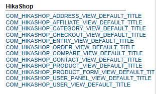

At this point, the front end cart will not work - when I try to add something, an "undefined" shows up in the Cart module. Also if I try to add a HikaShop menu item, the text is incorrect - see attached hikashop-error-menu.PNG

That's not a bug. It doesn't work because you had query errors during the update, so the database structure couldn't be updated properly.
Do like that:
- Turn off the debug mode option of the joomla configuration
- In phpmyadmin, edit the hikashop_config table and change the 'version' entry from 1.6.0 to 1.5.5
- rename the folder administrator/components/com_hikashop to something else.
- install again the 1.6.0
That should add all the necessary columns in the database and solve your issues.

Those steps fixed the issue. Thanks.
Now I am able to move to the upgraded versions, not just for Joomla 2.5.7, but the Hikashop Busines 1.6.0 as well
