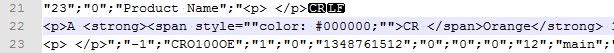

Hi all,
I have found a strange thing when I tried to open up the exported product.csv in notepad++ with displaying the special characters CF LR also.
Example:
"23";"0";"Product Title";"<p> </p> CR LF
where "23" is the first coloumn: product_id. For some reasons, CR LF exist in the line and breaks the folowing coloumns of the product to the next line, which is not correct. I'm also using an Open source CSV editor called CSVed where I noticed the coloumns shifting, and makes impossible to deal with the exported data at all.
Thanks in advance.

Yes, CF LR needed on win, at the end of line closing a product row. I attach an image where you can see that it breaks a line. In most cases, they are at the right place -> at the end of line. But sometimes breaking the lines to two or more like on the image.

That's your product description. It's on several lines because you have it on several lines.
That's not a problem. most CSV software like OpenOffice and Microsoft Office support multiple lines.
I can't do anything for you if your software does not support it besides telling you to use another software or not use several lines for your descriptions.
