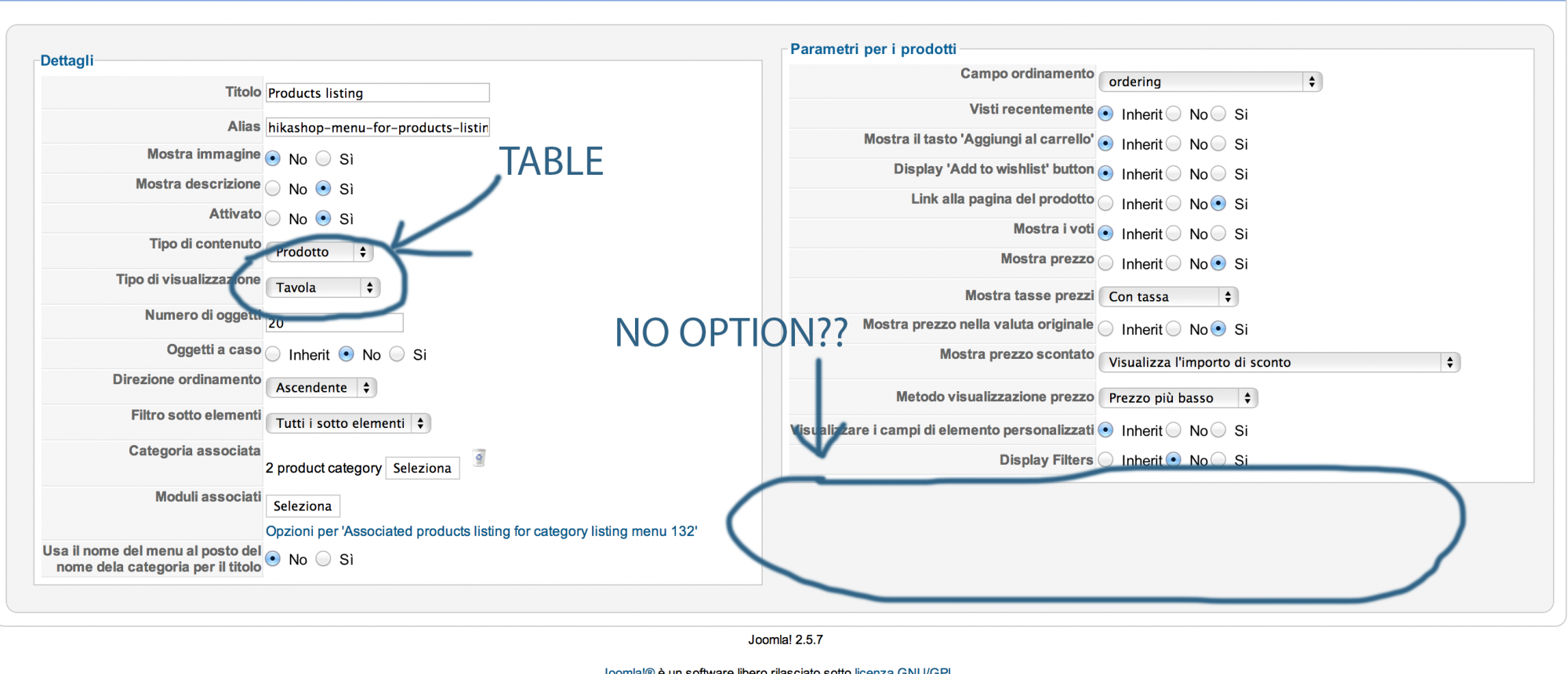

13 years 10 months ago #69800
no option for table layout
13 years 10 months ago #69803

  • Posts: 25
13 years 10 months ago #69804
I tried but does not work

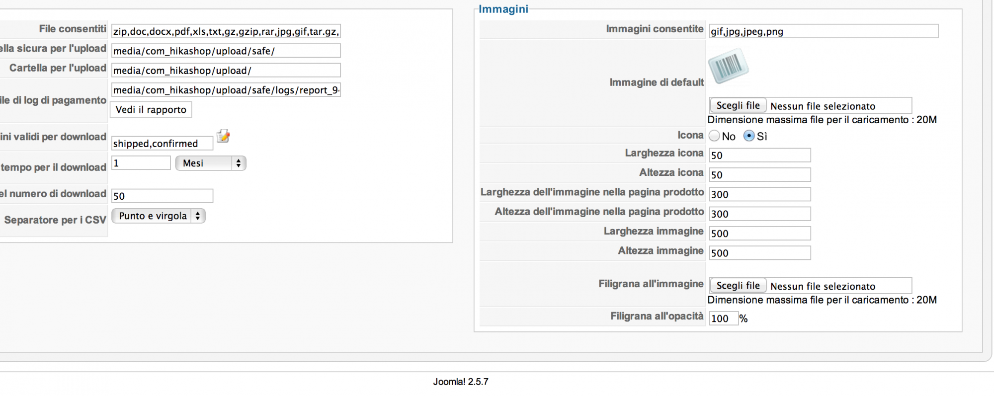

  • Posts: 25
13 years 10 months ago #69944
1.The fields are not empty!
I set the image size to 300x300 for product page, and 50x50 for thumbnail.

  • Posts: 86094
  • Thank you received: 14197
13 years 10 months ago #70016
1. Then, it means that in the hikashop options of your listing menu, you have set the images width/height to 300*300. If you leave them empty, it will take the size of 50*50 that you have in the configuration.

  • Posts: 25
13 years 10 months ago #70060
1. My configuration are correct the problem is in file listing_table.php, I followed also the instructions of Mohamed;
now if is set product page image size on configuration, the thumbnail size is ignored.
