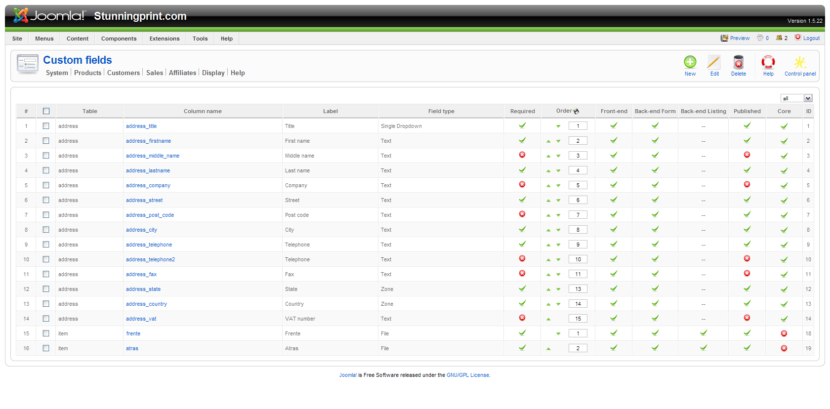

Could you make a screenshot of the options of your custom field so that we can try to reproduce the problem ?
  • Posts: 188
15 years 6 months ago #7275
I activated the option and try again but still not work , look the pic.
