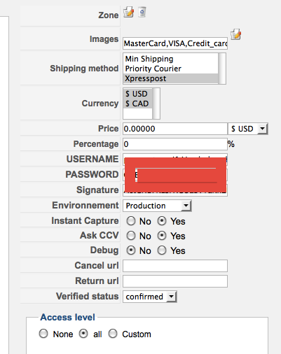

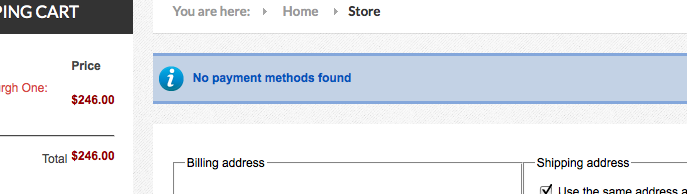

13 years 9 months ago #76776
I just tried the above, and I am still having problems. Still says 'No Payment Methods Found'
13 years 9 months ago #76779
Can you post a screenshot of your payment plugin configuration ?
Thanks,
  • Posts: 26
13 years 9 months ago #76781
sure.
13 years 9 months ago #76783
Your payment plugin is link to the shipping method "Xpressport".
So, your customer have to select this shipping method if he want to use your payment plugin.
Use the same technique than the currency to select all shipping methods (or none, like explain in the previous post).
It should fix your problem.

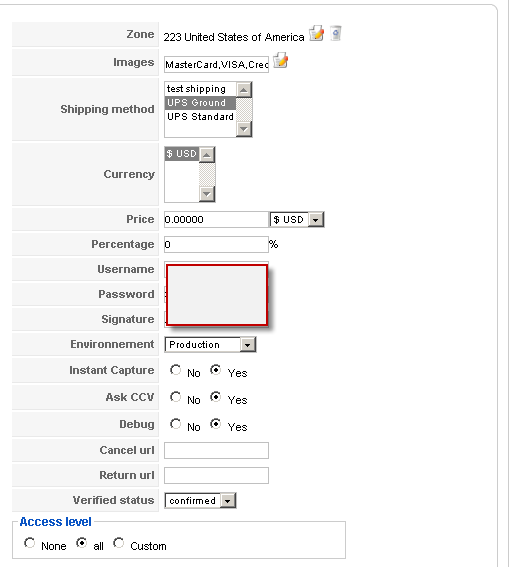

  • Posts: 2
13 years 9 months ago #78158
I'm getting the same error with my pay pal pro payment method.
I only have USD currency and believe the screens and checkout flow are setup correctly.
Here is the error:
Here is my setup:
Any info would be greatly appreciated.
13 years 9 months ago #78167
Your payment plugin configuration is link to the shipping module "UPS Ground".
As you can see in your screenshot, only this shipping method is selected (with a grey-dark background).
Si, the customer must select "ups ground" if he want to pay with paypal pro.
So, please select all shipping methods (or select none ; it would have the same effect).
Use the "shift" or "ctrl" key while clicking on items in the list in order to add/remove items in the selection.
