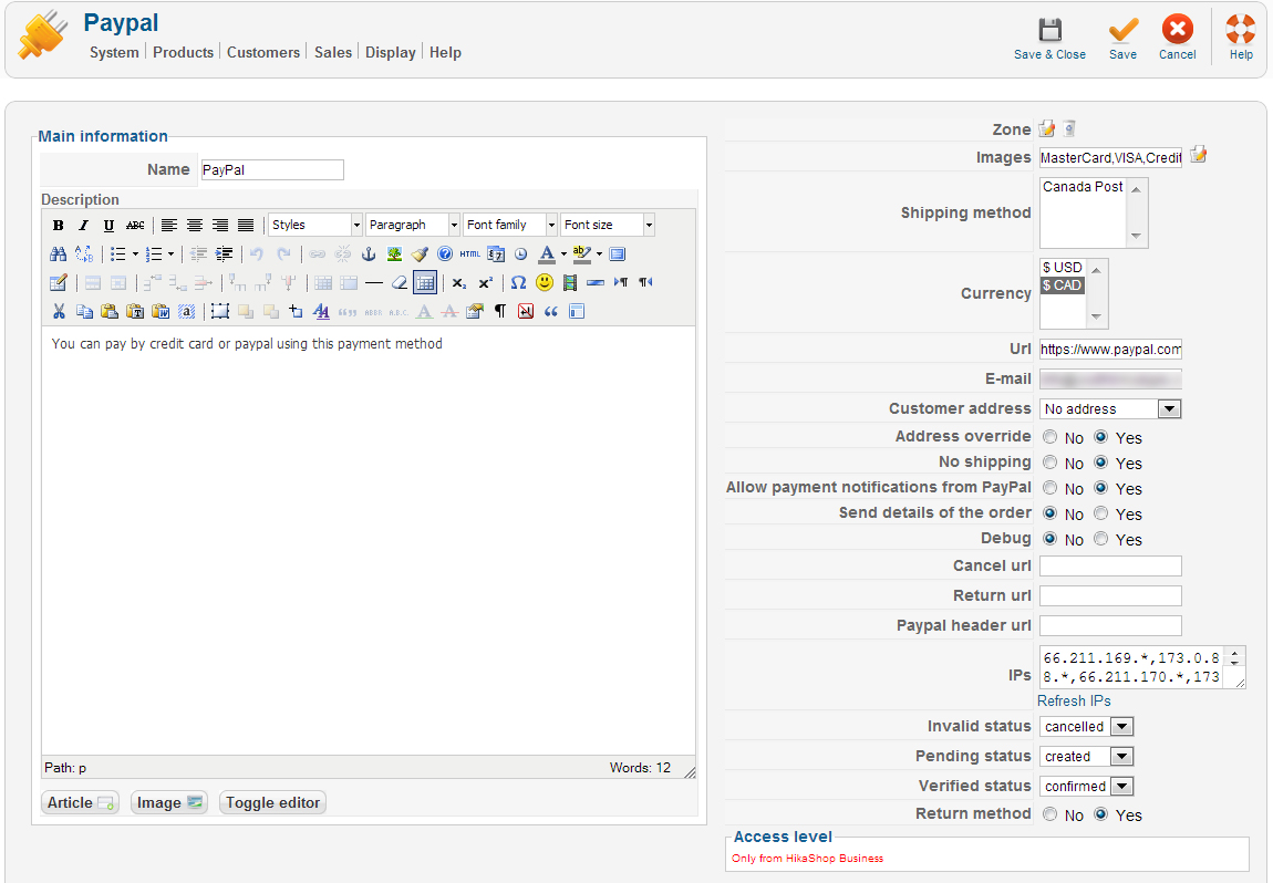

I am having issues with the paypal plugin, I have attached a screen shot of the error
I have been working through the following FAQ answer, that I have seen posted.
www.hikashop.com/en/support/documentatio...plugins-listing.html
I have added my comments with each item. As far as I can tell, I have completed each step, unless I am misunderstanding something.
Thanks for your assistance!
Rich

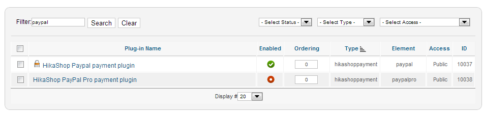

1/ Check that the payments plugins are installed and published
Yes it is
2/ Check that you have configured your payment plugins (edit it and save its configuration)
Done to the best of my ability, see screen capture

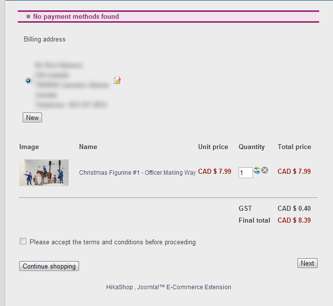

3/ Check that your template is able to display error messages: www.hikashop.com/en/support/documentation/61.html
Shows the following error message "No payment methods found"

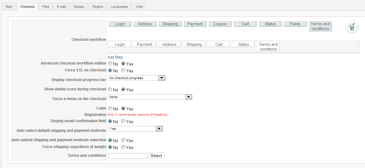

4/ Check that you have the payment view in the checkout workflow option of the configuration
Complete, see screen capture

8/ When you select a currency or a shipping method in the options of the payment method, the payment method won't display unless that currency or shipping method is selected during the checkout. In most cases, these parameters shouldn't be selected so make sure they are unselected. To unselect them, you need to press the ctrl key and click on the selected currencies or shipping methods.
This is unselected, see above screen capture.

13 years 10 months ago #73136
Can you try to use paypal for all currencies ? (without any currency limitation)
  • Posts: 10
13 years 10 months ago #73155
I have nothing selected in the currency list. But it still lists US and CAN currency. Same result, won't show any payment method.
Last edit: 13 years 10 months ago by richm.
  • Posts: 86181
13 years 10 months ago #73240
In the currency option of your payment plugin options, we can see that you have the CAD currency selected (looking at your screenshot), so it means that the payment method will only display for the CAD and not the USD currency.
To unselect the currencies, you need to press the ctrl key and click on the selected currencies. Then, just save.

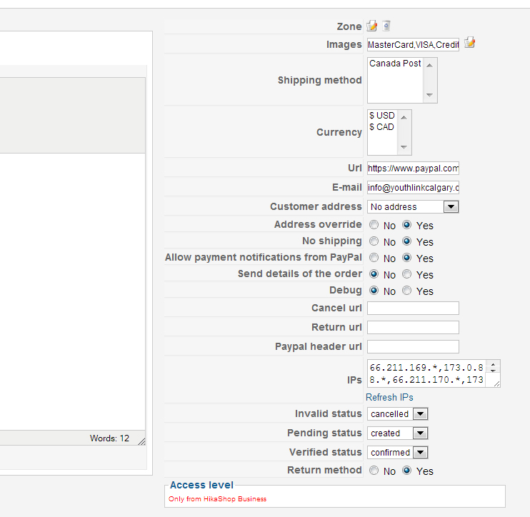

  • Posts: 10
13 years 10 months ago #73375
Hi Nicolas, I should have posted another screen capture after I deselected the currency in the paypal payments settings.
Unfortunately I am still getting the same error.
Thanks for the assistance.

  • Posts: 10
13 years 10 months ago #73773
Still only says "No payment methods found"
Is there another place that the error message might be posted? Maybe on the admin side. Something I can copy and paste here?
Thanks for all your help.
I might try a clean joomla install as a test and install hikashop, so see if it works on a plain site. Maybe it is a server issue.
