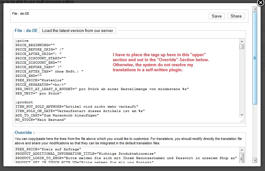

I'm currently try to write an own shipment plugin for HikaShop. I found out, that if you have a label-text like:
echo JText::_( 'SHIPPING_MAX_VOLUME' );
(or your own like mine: echo JText::_( 'SHIPPING_MAX_THICKNESS' ); )
that the System only lookup for the translations in the "upper area" of the language tags and not in the "override-section". I know it's wired what I say but unfortunately there is no title that I can use to describe where I mean.
Please have a look at the picture that I made.
This is not very good since, if I download the latest language version from server, my changes are gone!
Best regards
Mike

If you add the translation in the override section, the text should be translated and you will keep it when you update.

Xavier wrote: Hi,
I know, but if I add a translation to the override section that is used in a plugin and shown in the Backend, then the translation won't work. It only works if I add it to the upper section that will be overwritten when I update.
13 years 9 months ago #74530
It should work, I think that you have an error in your override part, for example a quote " not closed, or something else.
Try to enable the debug language in the joomla configuration, and you will see the error and you will see too that the language file override is loaded.
