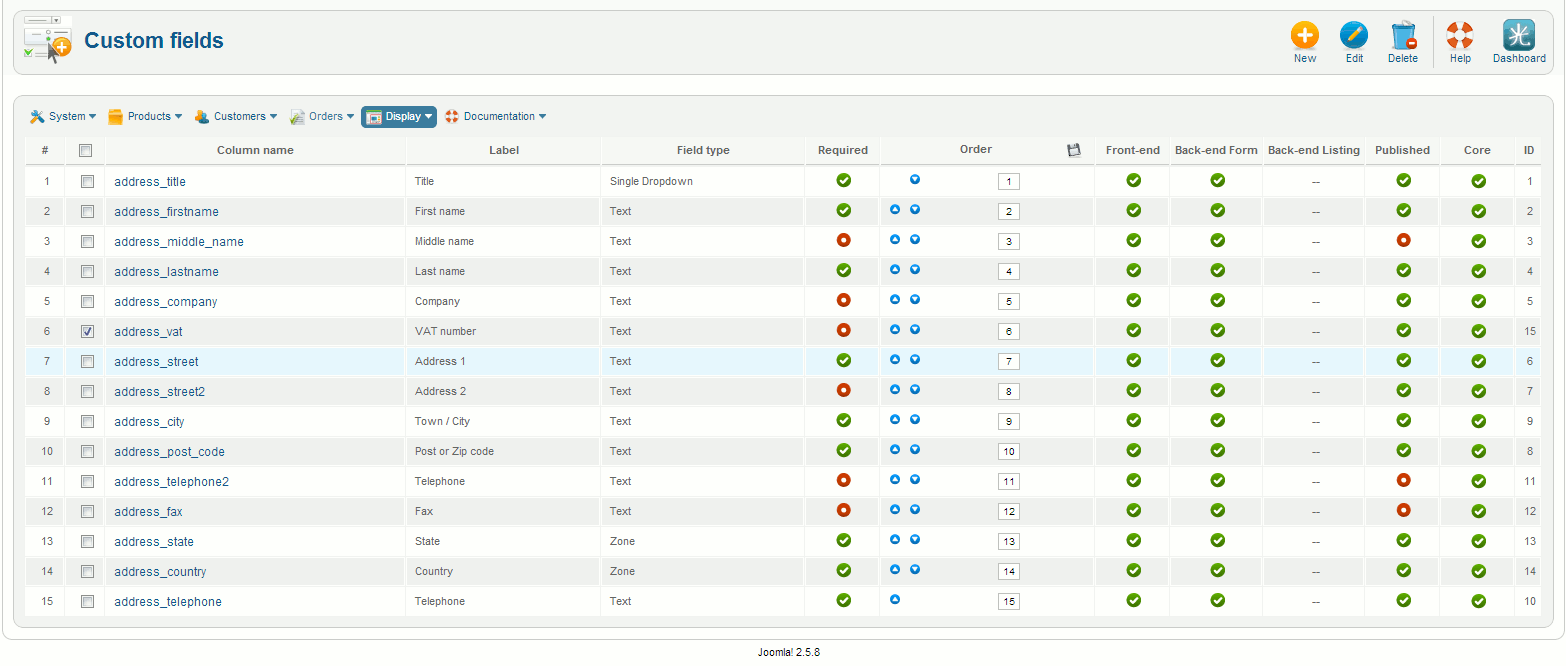

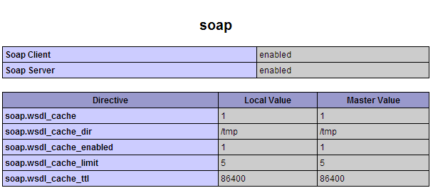

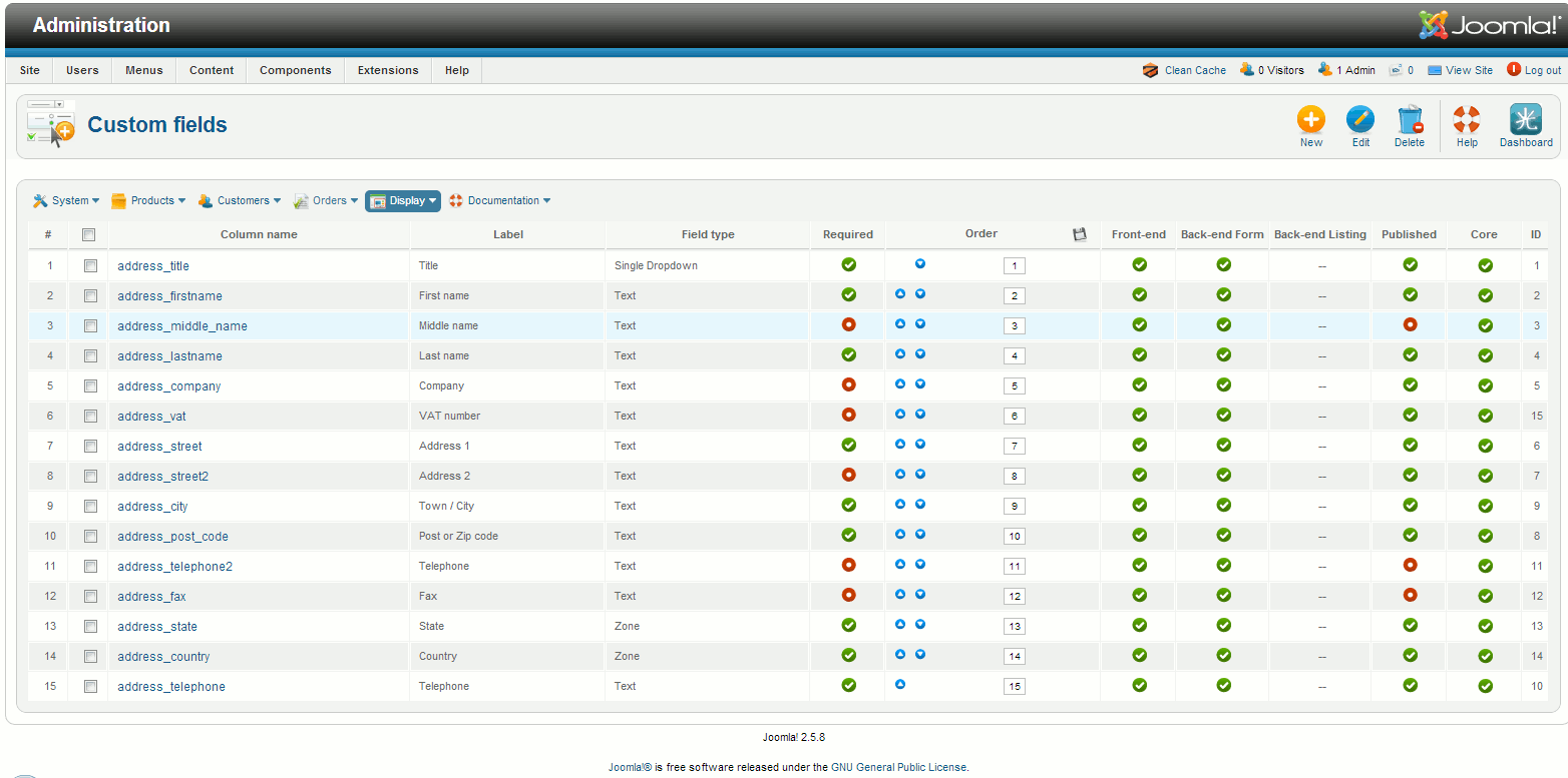

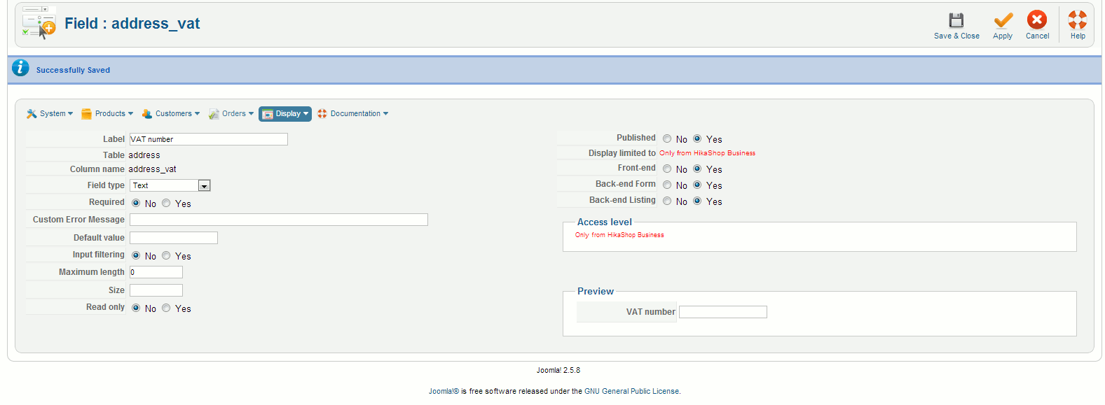

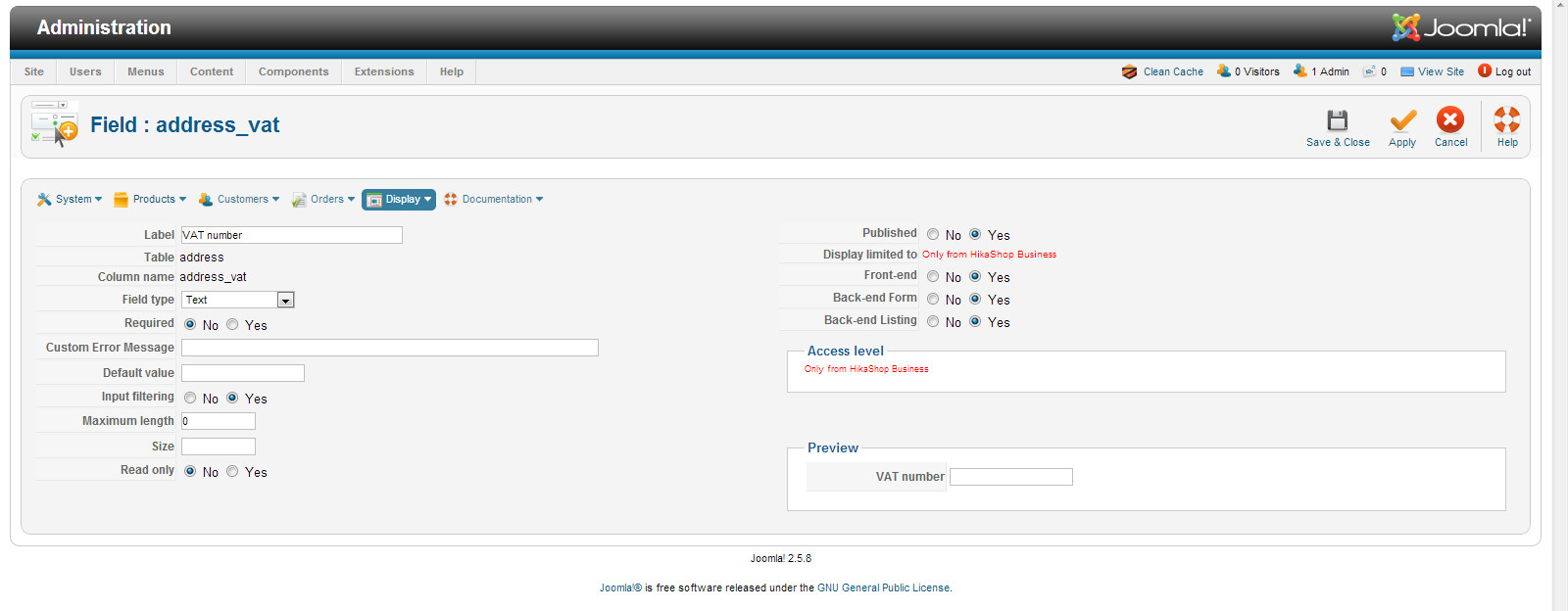

I am testing a new HikaShop site for a client and I've tried to set VAT number checking. I published display/custom fields/address_vat, and I've tried online check, and format check settings but neither of those works. If I register on the shop with a valid vat number, then vat is still added to the order at checkout.
My host is running PHP 5.3.20, and soap seems OK - see screenshot:

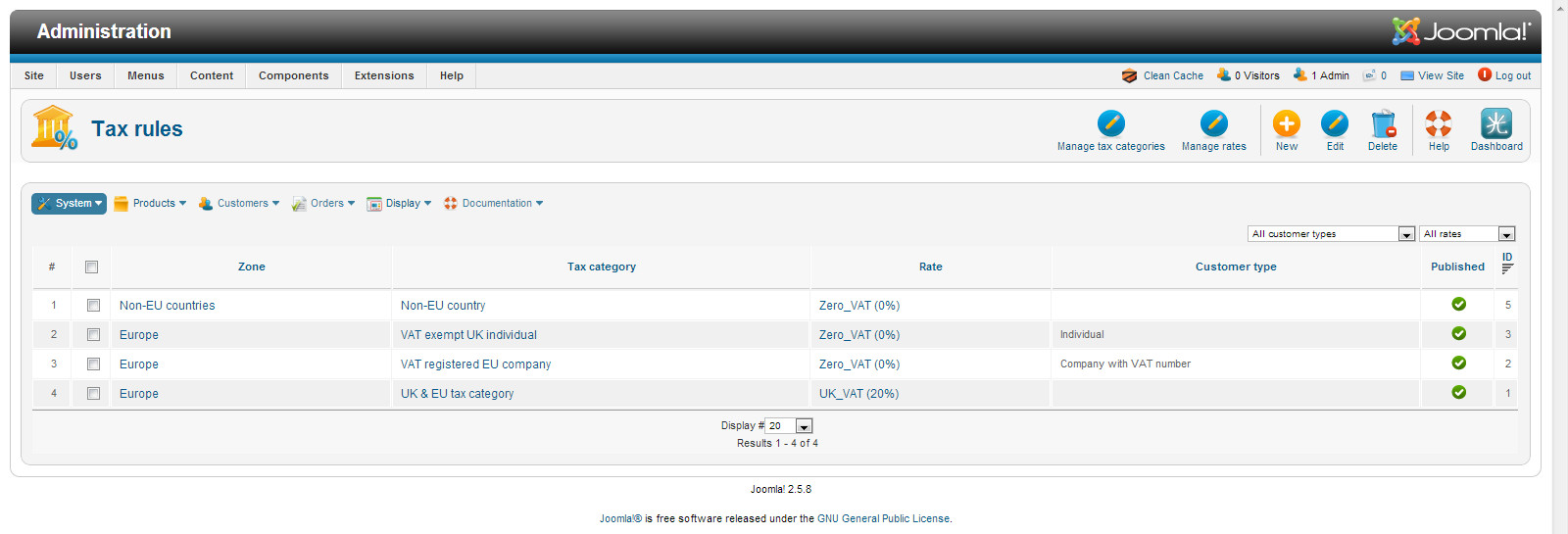

I have set and published a tax rule for "EU VAT registered company" at zero percent, and shipping zones are set up.

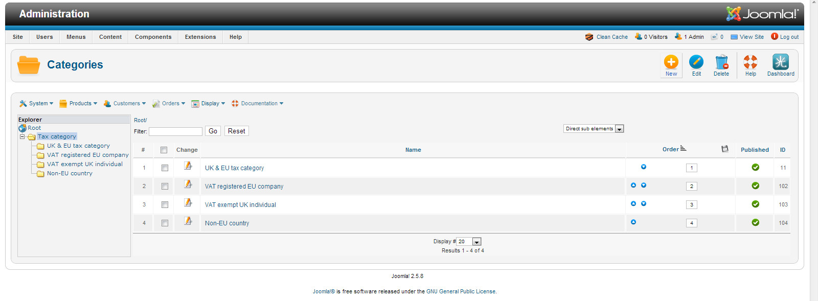

Restrict other tax to no VAT customers - I think so, please see screenshot "tax categories" but I'm not sure how these are applied to purchases.

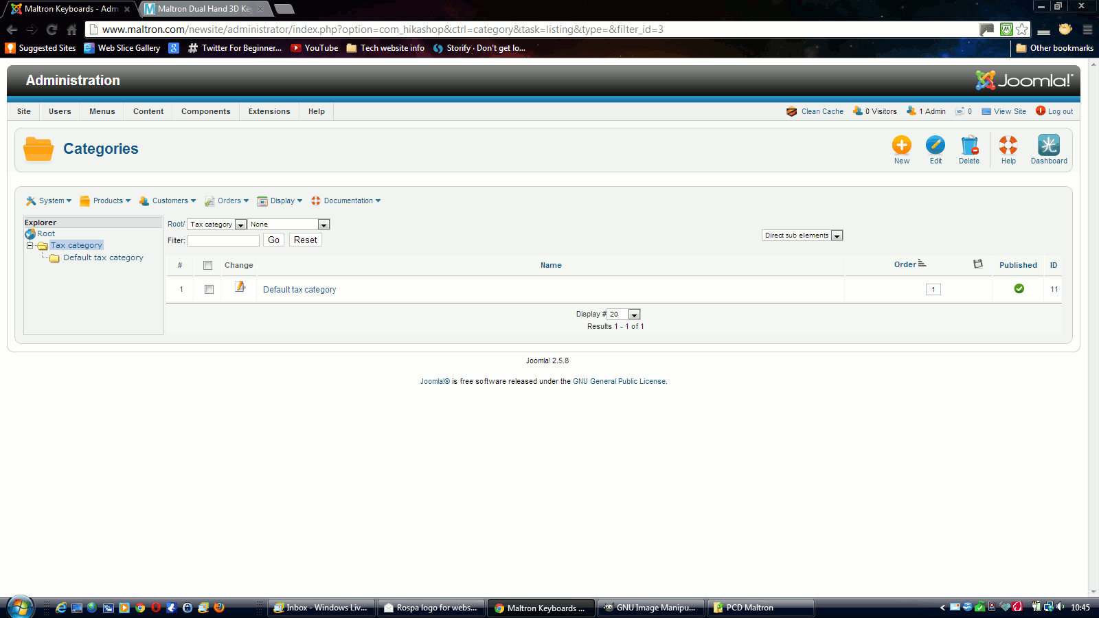

Regarding your tax categories, they are not correct. Tax categories allow you to define different tax rates for different types of products. For example, if you sell alcohol, it might be more taxed than food or books. In most cases, you only need ONE tax category (the default tax category which is already there should be enough). And you need to make sure that each product is assigned to the correct tax category which is likely not the case at the moment on your website.

I now have only one "Default" tax category. I checked all the products and they are assigned to "Default tax category".

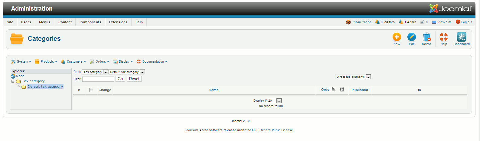

I have attached some new screenshots and I'd be very grateful if you could have a quick look and tell me where I'm going wrong regarding the VAT check. I've followed the documentation as best I can but still no luck :(

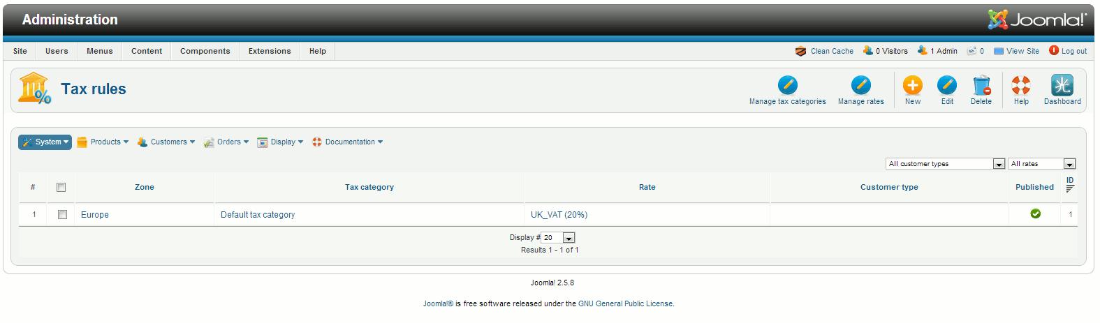

13 years 6 months ago #90095
So you have created one tax rule which apply to all the customer types in Europe for all the products.
What you want is actually to have two tax rules. One for the customer type "individual" and one for the customer type "companies without a VAT number".
Thus, the companies with a VAT number won't have any tax rule matching with their type of customer and no VAT will be applied for them.

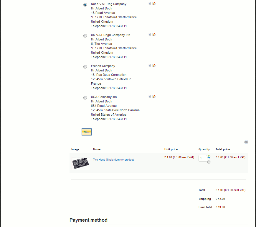

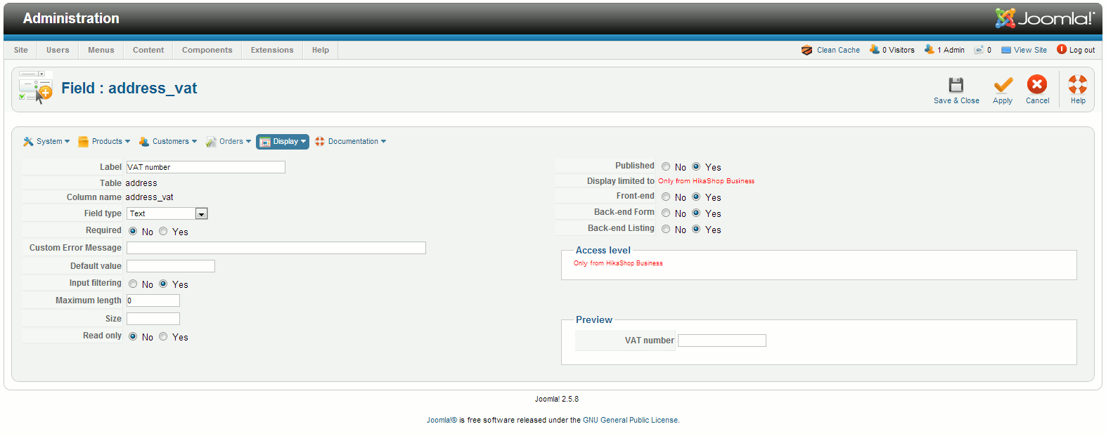

13 years 6 months ago #90698

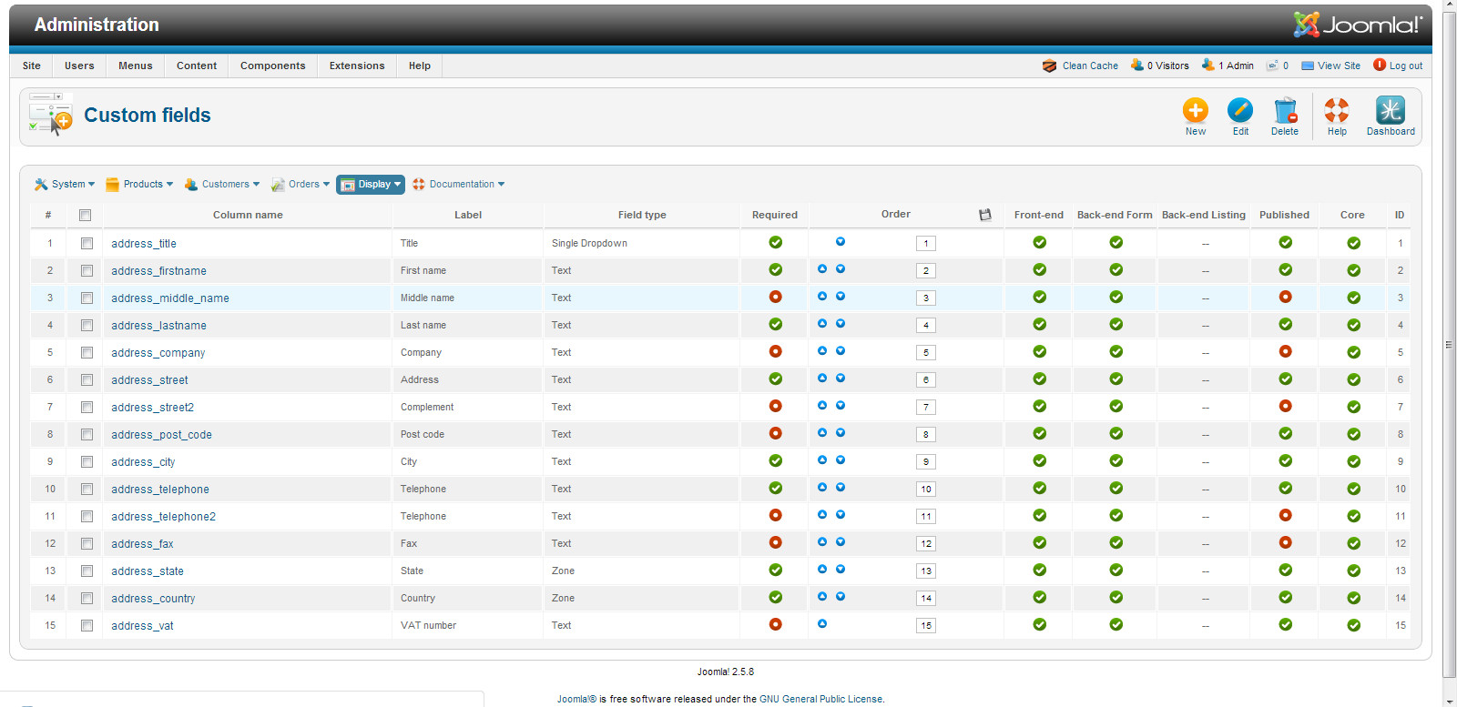

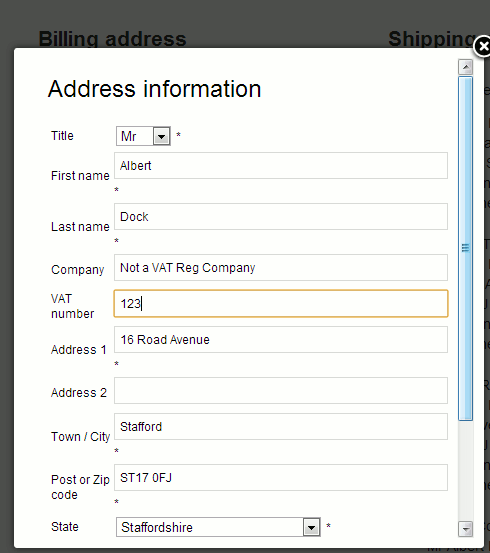

Thank you again for your help and for your reply. I'm fairly sure I now have the tax rules set up OK, and VAT is being added or not added depending on the address. But the VAT check is still not happening. I have attached screenshots of the custom field setup, the address input popup, and the total screen. As you can see, If I enter a rubbish VAT number like "123", no check is done and VAT is taken off the total. If I remove the 123 and leave the field blank, then VAT is added as it should be.
Your help once more would be very much appreciated!

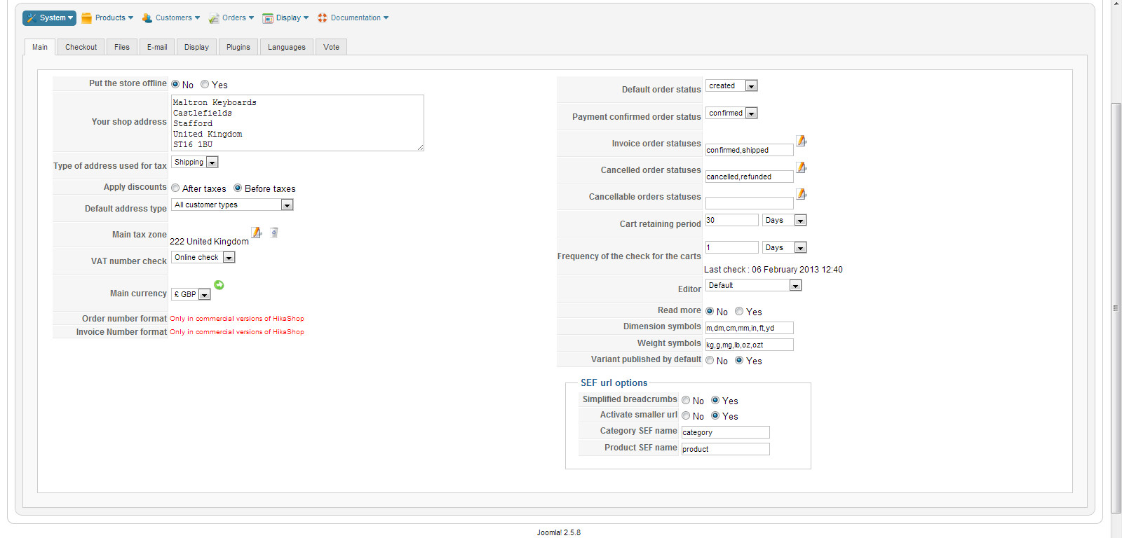

13 years 6 months ago #90816

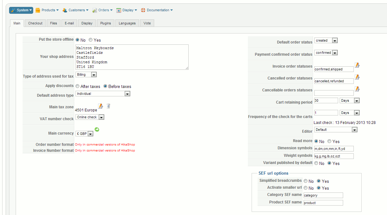

Have you enable the option "VAT number check" in Config > Main > Taxes ?
  • Posts: 21
13 years 6 months ago #90844
Hi Xavier, thanks for your reply.
Yes - it is set to "Online check".
I have also tried "Format check" but it does not work.
Is there anything else I can try?
Many thanks,
Mark
  • Posts: 86089
  • Thank you received: 14196
13 years 6 months ago #91024

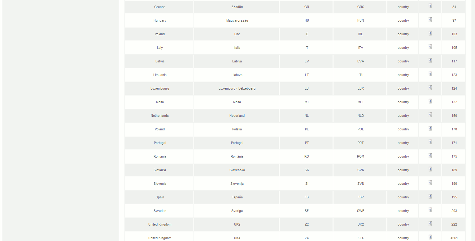

The VAT check is working fine for us and doesn't let us enter 123 for the UK. Are you sure that you didn't change your zones via the menu System->Zones ? That could explain why the VAT check is not enforced as it is enforced only for EU countries.
