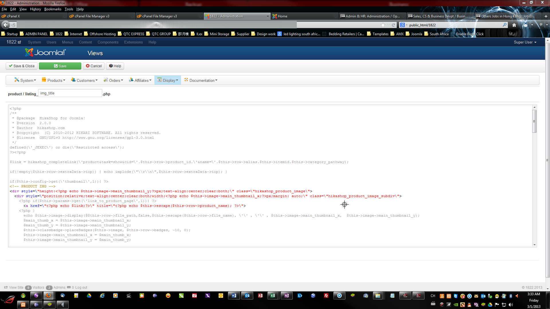

I am using php 5.322 / joomla 3.0.3
template use : Default protostar joomla 3.
Hikashop 2.1.0
Whenever i save a view / css file .
there is a "\" infront of the sign.
please help help . got stuck on my work .
the [\'] is everywhere.
any idea how to fix this ? thank you .

13 years 6 months ago #92490
It means that you have the register_globals option of your server turned on.
It should actually not be possible to install Joomla 3.0 in that case as it is required that this option is turned off since Joomla 3.0
Some links regarding that:
www.phil-taylor.com/2006/08/17/how-to-tu...ls-off/#.US_xxjDjg1I
docs.joomla.org/Register_globals
discussion.dreamhost.com/thread-91708.html
I would recommend you to contact your hosting company regarding that issue as changing that value on your webserver can greatly vary based on how it was configured.

Hello. the global register was off already . :(
still have this in joomla.
Any other ideas? first time happened to me. no idea how to fix .
  • Posts: 17
13 years 6 months ago #92545
i got it fix. magic quotes off. just letting you know * thank you!
