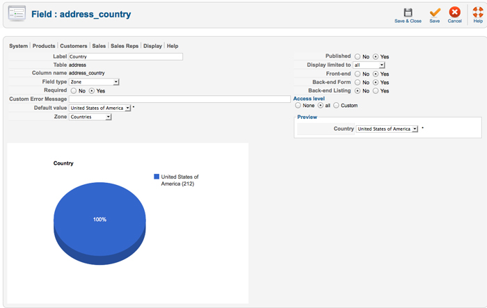

I just updated our Hikashop to version 2.1 Business after running 1.5.6 Business for over a year. After the update I notice some weirdness going on. The biggest issue is on the checkout page, the "States" drop down now has cities from France available for selection only. Previously, the default and only country was set for the USA, and USA States were the only available options under "States". The default and only country is still the USA on the checkout page.

It's not a bug. It's probably because of the way you configured your states/countries/custom fields with 1.6.
On each update/install HikaShop adds back all the states/countries and the links between them. So if you had deleted some of them, or deleted links between some of them, you could experience such strange behavior. But normally, you don't need and shouldn't delete them. You could simply unpublish the zones you don't need and make sure that the default value of each custom field is properly saved via the menu Display->Custom fields. I suppose that the default value for the countries and states fields is not correct at the moment on your website so it displays wrong data. Edit them, make sure that they have the correct data and save them and that should already help

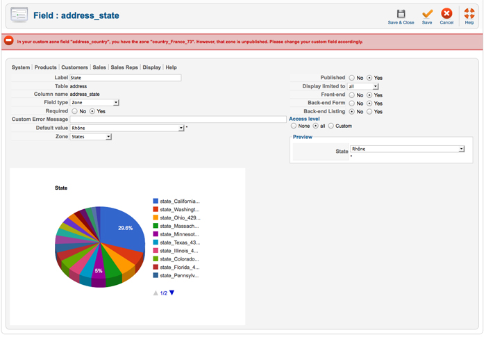

Why is it then that with the 1.5.6 configuration I get only USA STATES, and after the update I am getting CITIES?
Now that I have it restored to 1.5.6, in the custom field section, I am getting a strange warning. Any help of where I have gone wrong would be appreciated!

  • Posts: 86181
13 years 6 months ago #92500
It's not possible that you're getting French cities... There are no French cities anywhere in HikaShop or Joomla.
Please follow the recommendations of my previous message to fix the problem after the update.
