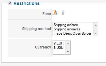

  • Posts: 21
13 years 4 months ago #99315
This is my Paypal setup:
I can add any other payment gateway without problems. Only Paypal has the problem.
  • Posts: 86089
  • Thank you received: 14195
13 years 4 months ago #99325
It's probably that your currency is not supported by PayPal.
  • Posts: 21
13 years 4 months ago #99349
The default currency in Hikashop is Ukrainian Hryvnia but Paypal is setup for US Dollars.
My question would be, which currency send Hikashop through Paypal: The Hikashop default or the paypal setup?
I'm using another gateay for Ukraine currency (Robokassa) and it works well.
  • Posts: 86089
13 years 4 months ago #99403
Neither.
What is used is the current currency.
If you see the prices in USD on the checkout, the payment plugins will use the prices in USD and thus paypal should show up.
If you see the prices in Ukrainian Hryvnia, the payment plugins will use that currency and thus paypal won't show up.
You can use the currency switcher module of Hikashop if you want to be able to easily switch from one currency to another.
