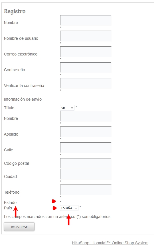

Hi, when a user is registered in my store, the state is not displayed, only the country. Once registered, you can edit the address and add the rule correctly, but in the register process does not appear to select the state.
What could be the problem? I attached a file where I have marked with red arrows where states should appear. The capture is in Spanish.

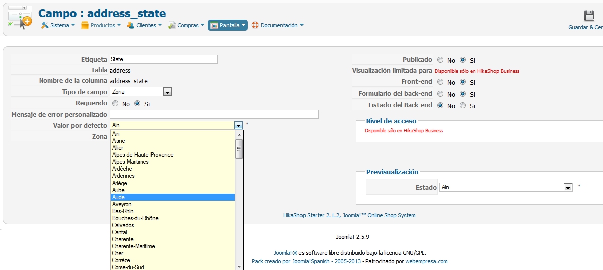

Hello, I've been there and address_state field, the provinces are not my country, I send you a screenshot for you to see. How I can put the provinces of my country? I tried creating a new field, select Area and still appear the other provinces ... Thank you.

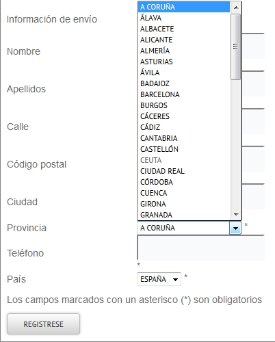

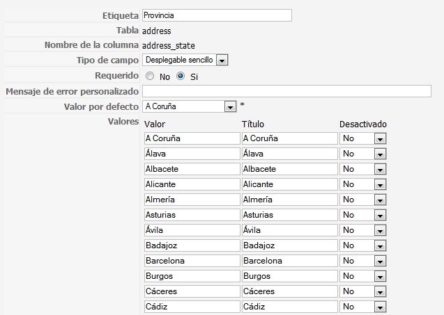

  • Posts: 107
13 years 4 months ago #101069
Thank you. The country was also published and provinces. Before reading your post, I decided to change the field type from "Zone" to "Drop Down Easy" and manually add the provinces. Now is fine. I enclose two sacks. Thanks for all, greetings.
