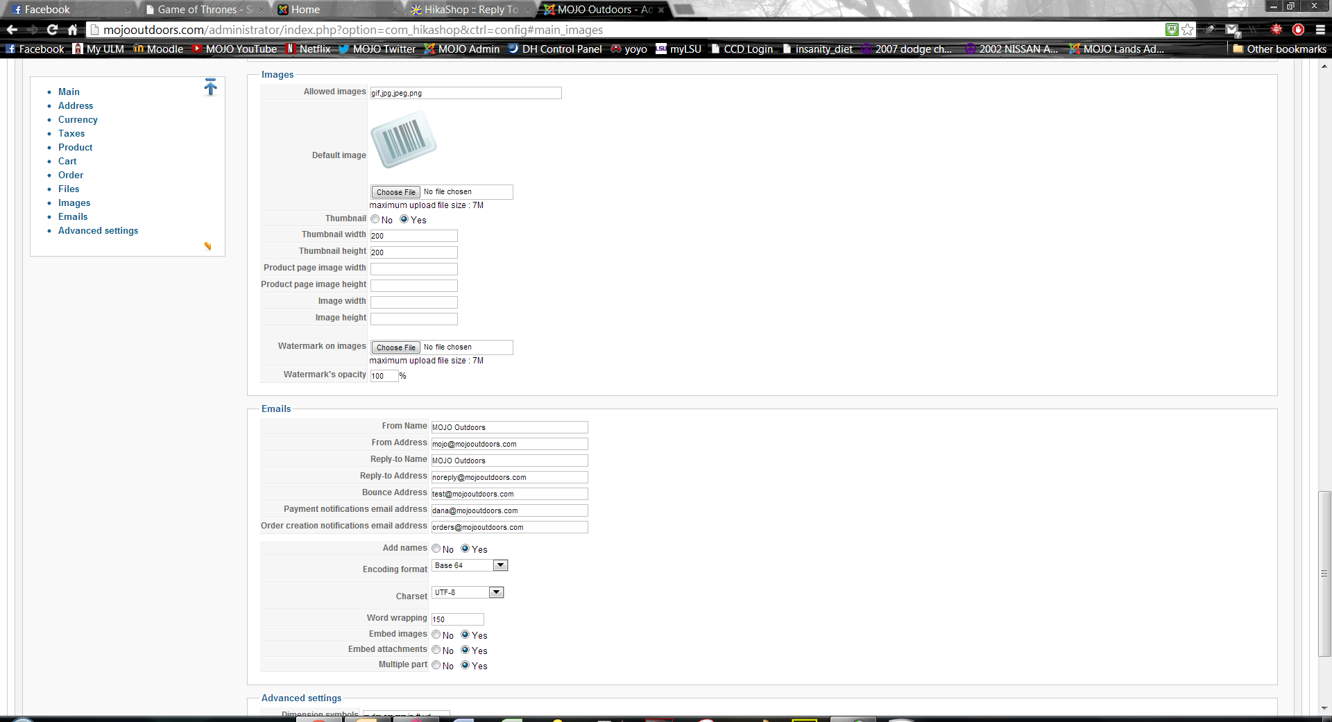

13 years 3 months ago #105706
Can you give us a screenshot of your images configuration ? (Configuration > Main > Images)
  • Posts: 303
  • Thank you received: 18
13 years 3 months ago #105748
Here is the screenshot of the images configuration.
Also, I updated hikashop to the latest version and it did not fix the thumbnail issue nor the add to cart problem.

13 years 3 months ago #105861
1. The fact that none of the thumbnails display anymore after the delete the thumbnails folder is good. It means that you simply have an access right issue to the upload folder (HikaShop/joomla is not allowed to write files/folders into the folder) and that's why HikaShop cannot regenerate the thumbnails automatically.
Simply fix your upload folder permissions via FTP (you can set them to 777 and that should be enough hopefully) or contact your hosting provider to help you with the change.
2. Regarding the add to cart button, I tried it on my end on your website and it's working fine. Maybe you didn't see that it was working because of the cache of your browser. Try with another browser.

13 years 3 months ago #105950
I changed the permissions of the upload folder and deleted all the thumbnails again. However, nothing changed. So, I tried setting only one of the size constraints on the thumbnails and it worked perfectly. I believe the access rights issue was the main culprit.
Also, we fixed the add to cart issue late last night. Turns out it was an ajax issue.
