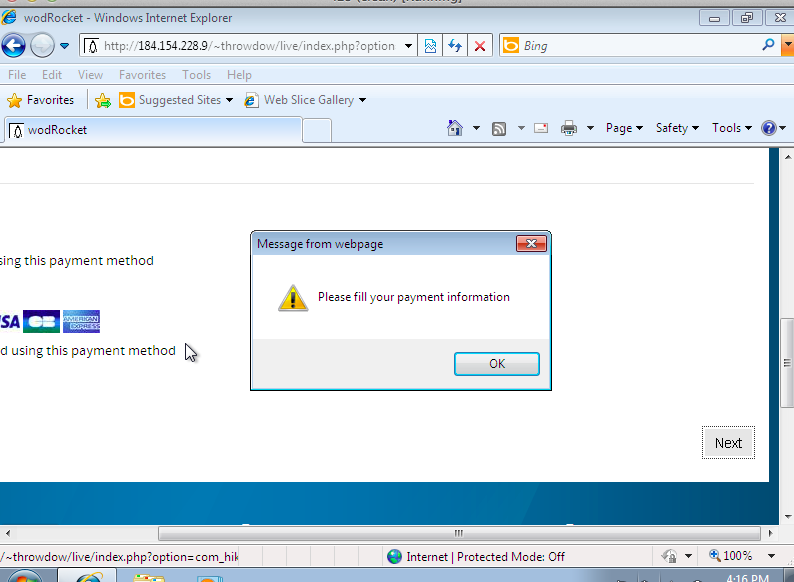

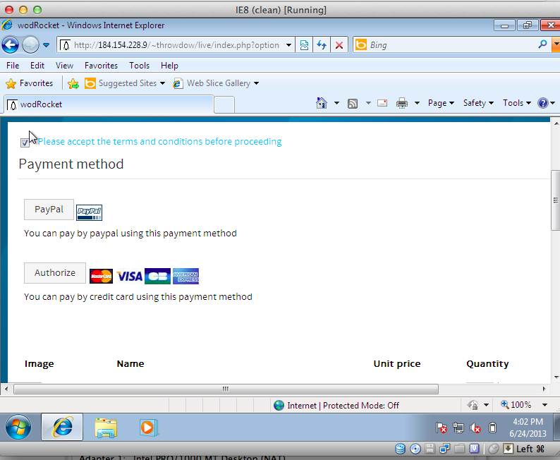

I have users trying to buy products but in IE8 they call and say they can not select Authorize.net or PayPal.
I tried myself and this is due to bootstrap template which i really need.
Go here in IE8 to see my point:
184.154.228.9/~throwdow/live/index.php?o...ct&task=show&cid=184
Screenshot attached.

13 years 2 months ago #110927
The problem does not come from HikaShop and I don't know why the label is not working correctly in IE8.
We do not use something tricky, it is just a label which is linked to the "input radio".
The "input radio" is hidden but you can display it. At this moment you can select the payment method using the radio.
You have to override the CSS in order to edit/add this rule:
.hika-radio input[type="radio"] {
	display:block;
