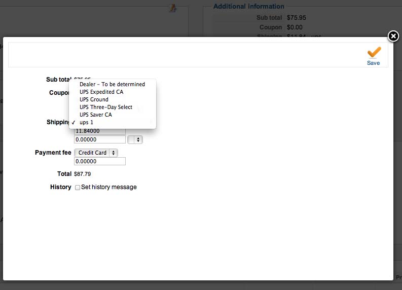

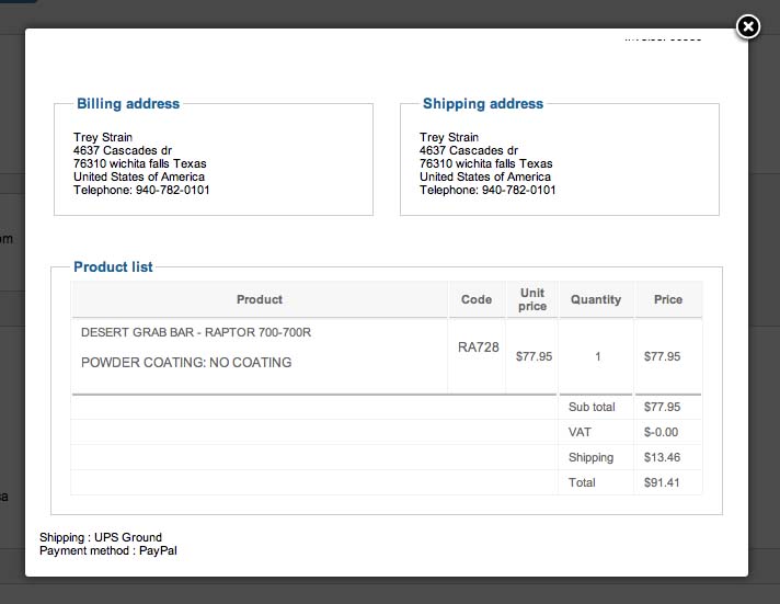

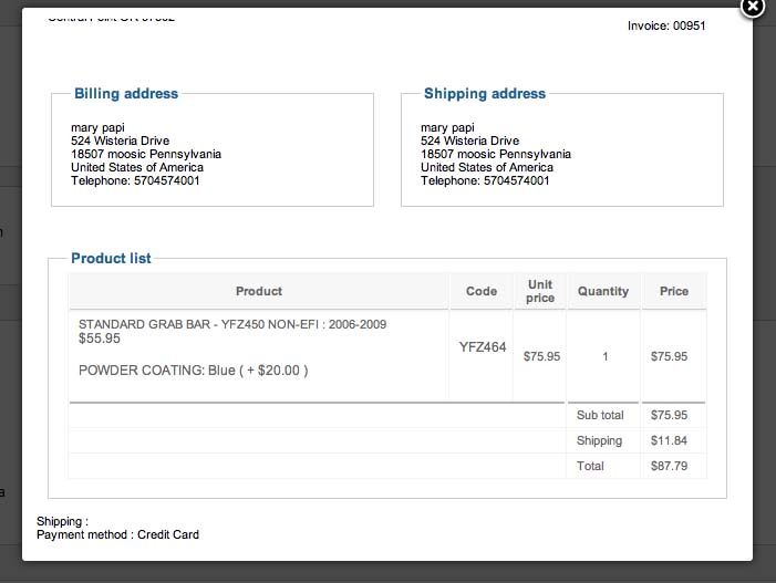

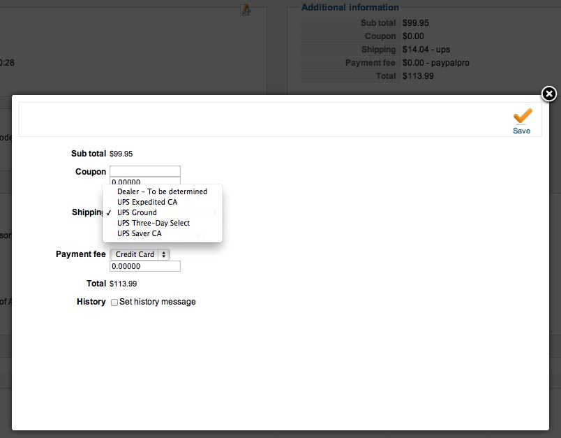

That code did not work either. I am thinking that the code for the email is not the problem. In the backend, my invoice last week before the update showed the shipping service(see screen shot)
, now it does not say anything(see screenshot).
If I click the edit icon in the "additional information", and click the shipping dropdown, it now has a UPS1 which is selected(see screen shot)
no matter which shipping method is selected. Before the update, it would show the correct shipping method, and ups1 was not even an option(see screen shot)
It seems to me that this may be causing the problem. Any idea what it might be? I can pm you my login info if you want to take a look.
Thanks again

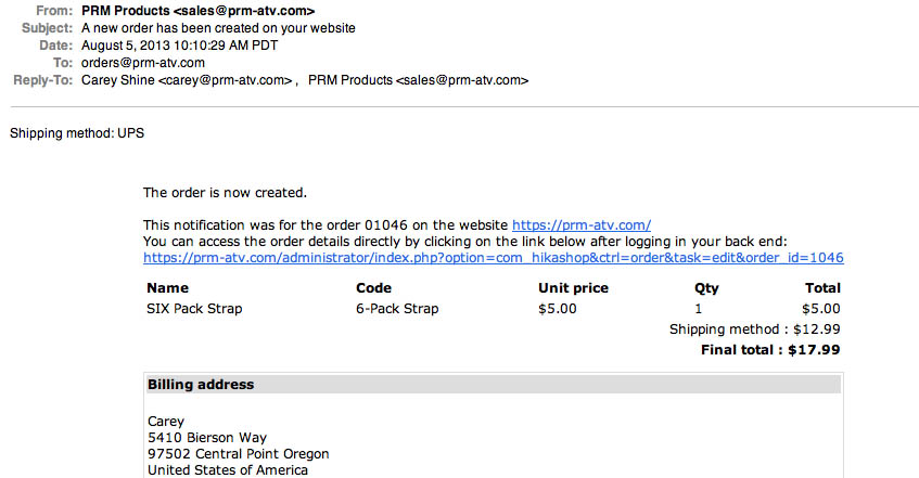

Okay, thanks Nicolas! That did work to solve it in my back end. I am now able to see what the order shipping method service was. Although it will still not display in my "order creation notification" email. I see in the backend it now shows "UPS-UPS Ground". I have tried the initial code i had been using;
<?php $shippingClass = hikashop_get('class.shipping');
$shipping = $shippingClass->get($data->order_shipping_id);
$shipping->shipping_params = unserialize($shipping->shipping_params);
echo 'Shipping method: '. $shipping->shipping_name; ?>
and I get just "UPS" no matter shipping service is chosen, like it is ony registering the first part of the shipping method but not the service.

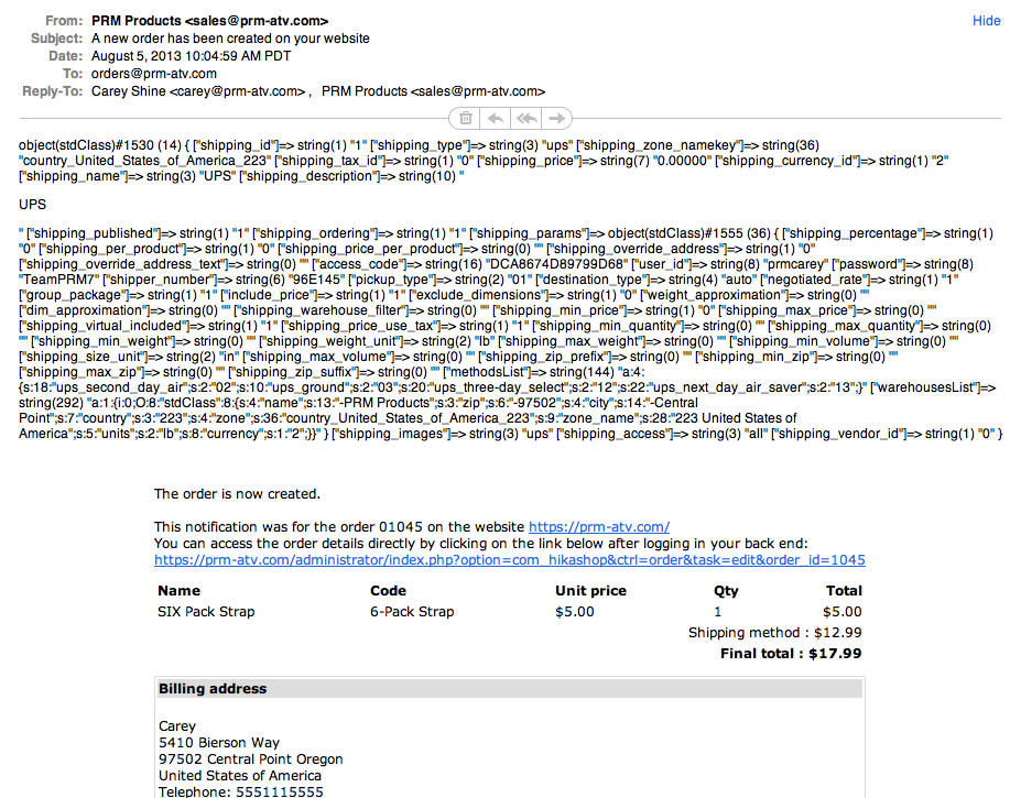

I have also tried the code above that Xavier suggested, but got something really wild;
I have also tried this code I found in another thread;
<?php echo 'Shipping Method: '.$data->order_shipping_id; ?>
and get "Shipping Method: 1-7" for UPS 3-Day Select, and "Shipping Method: 1-3" for UPS Ground, indidcating that it is identifying the different services, but not displaying the names.
Any suggestions?
