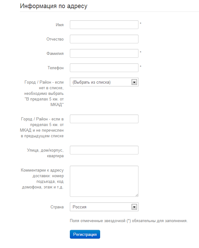

13 years 1 month ago #113605
Were you talking about these address fields (cf screenshot)? if yes, that's just the registration form and not and address step, then your customer will be able to verify and won't have to set their address through the address step.
  • Posts: 23
13 years 1 month ago #113624
nope... if you try to add products in the cart (beeing not logined), then go to checkout: 1st step is cart and coupon, push the next button -> 2th step login - enter test username and password - then push next button -> 3th step address - push next button -> 3th address step loadded again. And only if push the next button again it loading the next delivery step. So address step appears twice on some reason...
