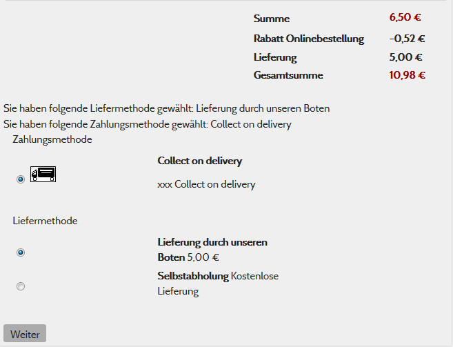

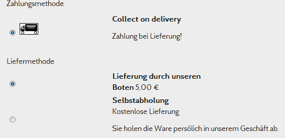

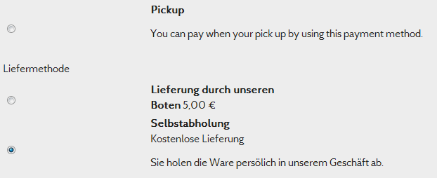

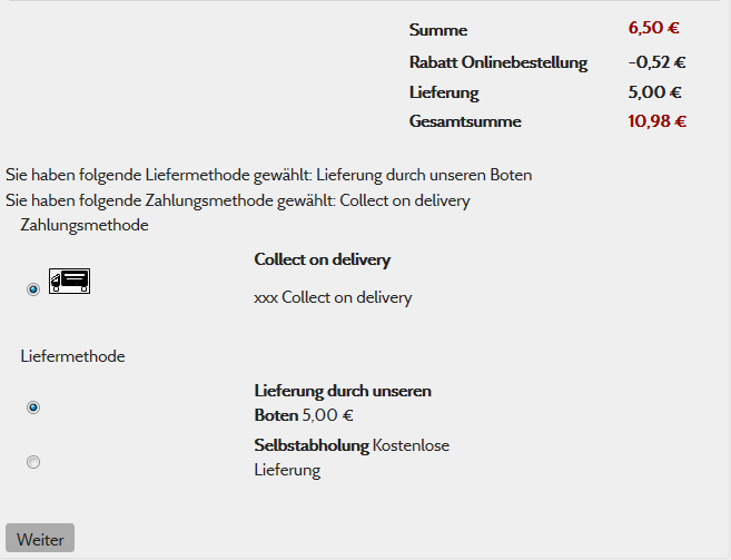

13 years 1 month ago #115487

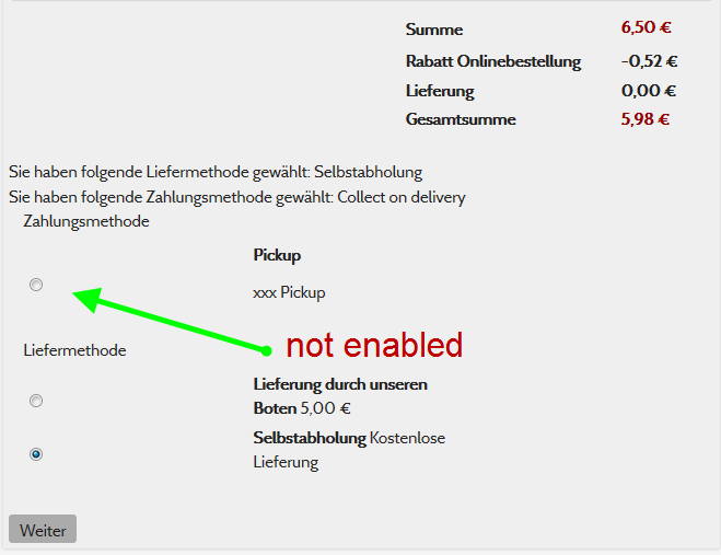

changing the delivery methode does not change the default payment methode
If I change to "pickup" (= Selbstabholung)
the delivery methode remains "Collect on delivery"

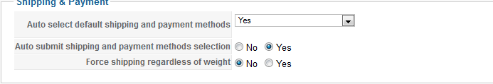

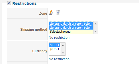

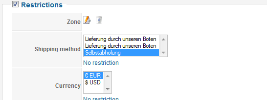

here the configuration
Collect on delivery
Pickup

13 years 1 month ago #115547
no, it does not work for me.
If I change the deliver methode to pick up (=Selbstabholung), the [ ] pickup button should be selected (not only displayed on screen)
my plan is, to display no payment method. because there is only one per delivery option. so this should be selected automatically.
