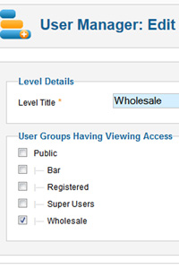

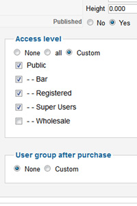

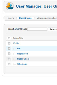

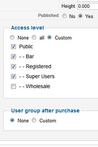

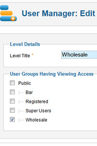

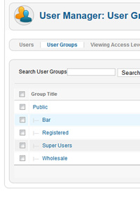

Here the setting in Joomla
Here the setting on the product that should be not visible if the wholesale log in. (but it's visible)
Here the acess level of the wholesale
best regards
Raphael

That can happen if the wholesale group is under the public group (which is the case based on your screenshots) and that the option "Inherit parent group access" of the Access level tab of the configuration of Hikashop is turned on (it is turned off by default).
