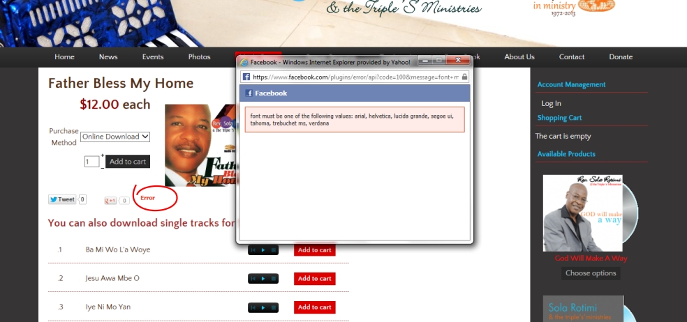

-- HikaShop version -- : 2.2.1
-- Joomla version -- : 2.5.14
-- PHP version -- : 5.3.x
-- Browser(s) name and version -- : IE10
Last edit: 12 years 11 months ago by aijosh. Reason: Resolved

13 years 2 days ago #121348
Could you install that new version of the "social networks" plugin via the joomla installer and try again ?
  • Posts: 10
12 years 11 months ago #124415
I have re-installed it but the issue still persists

12 years 11 months ago #124574
Can you try to change the font and/or the tag type options of the HikaShop social network plugin and see if that help ? Please make sure that you clear your website cache before testing.

  • Posts: 10
12 years 11 months ago #124585
Changed the font to Arial. And it worked fine.

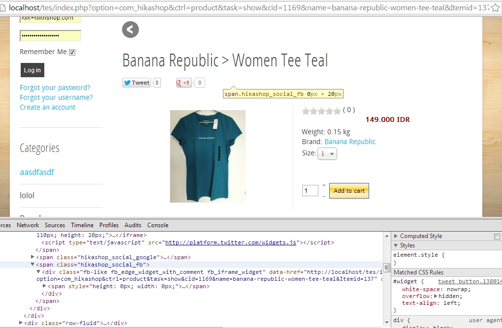

  • Posts: 51
12 years 11 months ago #125045
Hi Nicolas
-- url of the page with the problem -- : on localhost
-- Joomla version -- : 3.1.5
-- PHP version -- : 5.4.7
-- Browser(s) name and version -- : chrome 29.0.1547.76 m
I'm having this problem as well, facebook button just no where to be found. I've installed your latest plugin posted above, changed tag type, font, color, display style, cleared browser cache, and list goes on.. and still keep failing. please help =)

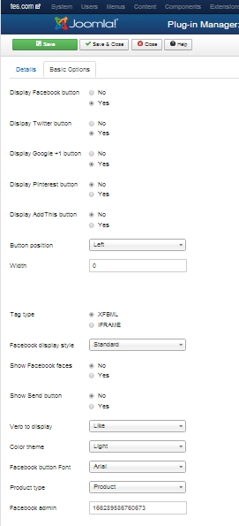

12 years 11 months ago #125072
Thanks to check the parameters of the plugin, have you enabled Facebook and set your id.
  • Posts: 51
12 years 11 months ago #125097
Yes, facebook is set to yes, facebook id also set properly..

12 years 11 months ago #125174
It's maybe a css issue, a css property hide the facebook content.
Or a connection problem with the facebook API, you maybe can't receive the facebook response because you are on localhost.
