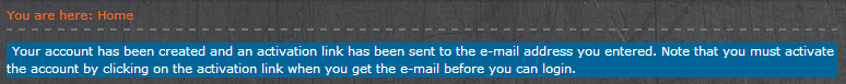

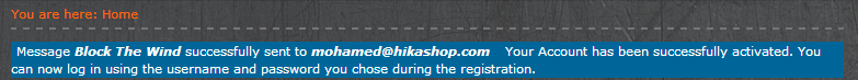

I've done some tests through your website and it seems like your registration process is working fine :
1. Yes :
2. 3. I received an activation email from your website.
4. Yes :
