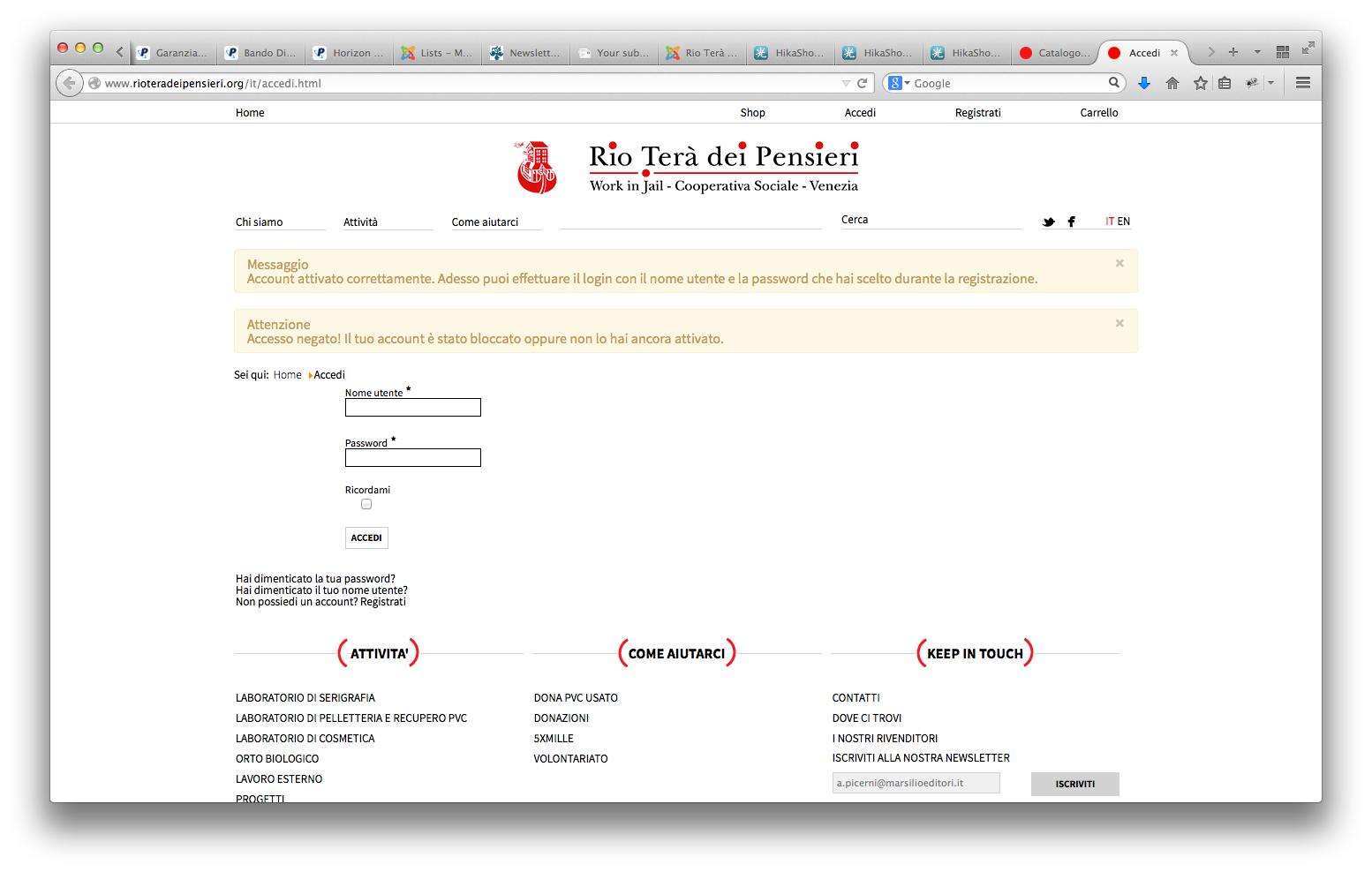

-- Joomla version -- : 3.3.4
-- PHP version -- : 5.3.29
-- Browser(s) name and version -- : Firefox 32.0.3
After user click on link in email confermation (like this
www.rioteradeipensieri.org/index.php?opt...356&Itemid=102&lang= )
Systems will show this two messagge:
Messaggio
Your Account has been successfully activated.
Account attivato correttamente. Adesso puoi effettuare il login con il nome utente e la password che hai scelto durante la registrazione.
Attenzione
Login denied! Your account has either been blocked or you have not activated it yet.
Accesso negato! Il tuo account è stato bloccato oppure non lo hai ancora attivato.
In back-end user is blocked.
I've just upload last Hikashop version from your site.
Can you help me please?
Best regards
Antonio

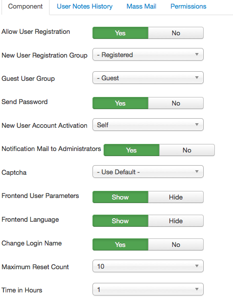

  • Posts: 15
11 years 11 months ago #174051
Nope. New User Account Activation is set on "Self". In attach my coinfiguration. I think that the problem is not in this set-up.
USER MANAGER:
allow user registration: yes
new user group: registered
new user account activation: self
Maybe this problem should be related with link activation in email?
