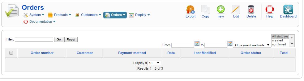

Perfect, I can process an order now... thank you. However, I've noticed (and I don't know whether this is related) that when I go into the orders list in the back end of Hikashop, although it says it is showing "Results 1-3 of 3", no actual orders are showing up.
11 years 9 months ago #181432
Please check in the database if there is any orders presents.
This is potentially due to the previous error, some orders have maybe not been fully completed.
  • Posts: 30
11 years 9 months ago #181538
Yes, there are orders in the DB in the jos_hikashop_order table.
I actually created these orders AFTER the fix above as I was unable to process an order before.
  • Posts: 86087
  • Thank you received: 14194
11 years 9 months ago #181551
Can you turn on the "debug mode" option of the Joomla configuration and try again ?
Do you get any error in that case on the listing ?
  • Posts: 30
11 years 9 months ago #181605
When I try to visit the orders page in the back end of the website with debug mode on, I get the following error...
500 - An error has occurred.
JDatabaseMySQL::query: 1253 - COLLATION 'utf8_general_ci' is not valid for CHARACTER SET 'latin1' SQL=SELECT a.*,b.*,c.*,IFNULL(c.name COLLATE utf8_general_ci,CONCAT_WS(' ',d.address_firstname,d.address_middle_name,d.address_lastname)) AS hikashop_name FROM jos_hikashop_order AS b LEFT JOIN jos_hikashop_address AS d ON b.order_billing_address_id=d.address_id LEFT JOIN jos_hikashop_user AS a ON b.order_user_id=a.user_id LEFT JOIN jos_users AS c ON a.user_cms_id=c.id WHERE (b.order_type='sale') ORDER BY b.order_id desc LIMIT 0, 20

  • Posts: 86087
11 years 9 months ago #181639
Replace the line:
$database->setQuery('SELECT a.*,b.*,c.*,IFNULL(c.name COLLATE utf8_general_ci,CONCAT_WS(\' \',d.address_firstname,d.address_middle_name,d.address_lastname)) AS hikashop_name '.$query,(int)$pageInfo->limit->start,(int)$pageInfo->limit->value);
with the line:
$database->setQuery('SELECT a.*,b.*,c.*,IFNULL(c.name,CONCAT_WS(\' \',d.address_firstname,d.address_middle_name,d.address_lastname)) AS hikashop_name '.$query,(int)$pageInfo->limit->start,(int)$pageInfo->limit->value);
in the file administrator/components/com_hikashop/views/order/view.html.php and that should solve the problem.
