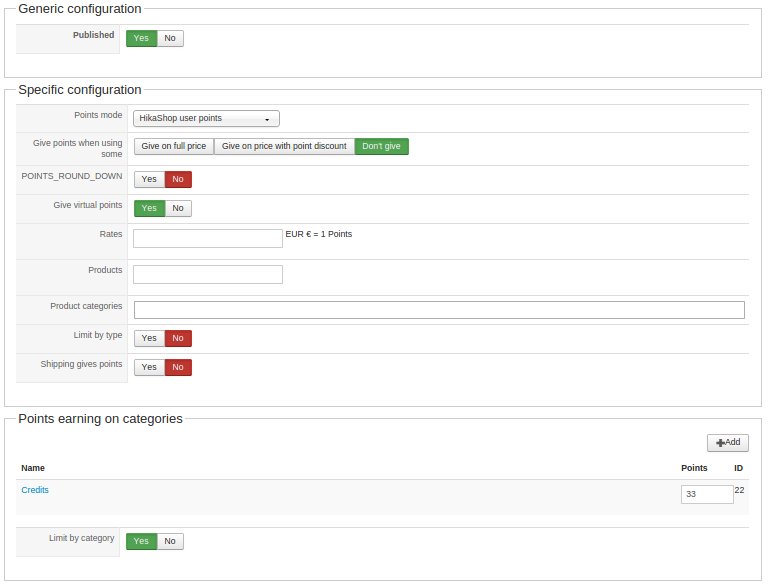

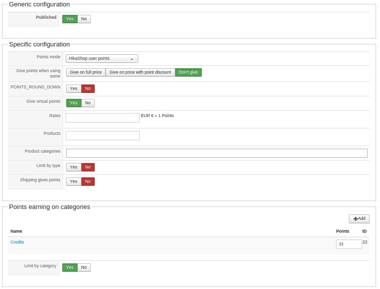

I have created:
- the custom field user_points
- a product inside category "credits"
- a new plugin userpoint, published with the following parameters:
When i try to buy a product inside category "credits" no points are added to the user.

Hi Jerome, problem solved. I checked "Invoice order statuses" as you suggest and it was blank. Now user points are credit but with an other problem.
When I set "Points earning on categories" no points are credit. I found a probably bug on hikashop/userpoints/userpoints.php at line 383:
$this->_makeLevel($all_category_ids[$id->product_id], 0, $sub_categories);
the _makeLevel function return always an empty array.
I commented the _makeLevel foreach and the
break 2;
in the following foreach and now it is ok (also summing points between multiple categories). I have not test with subcategories.
