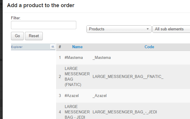

We found that the userpoint plugin is not working for order created directly in backend, frontend point is working perfectly for both AUP and HK
And also backend order category explorer is not showing at all, we have to filter out the product and variants name from filter to enter order in backend

2. Again the category explorer displays fine in the product selection popup of orders. Did you maybe turned it off in the Display settings of the HikaShop configuration ?

I had check backend configuration of categories explorer and sure it is turn on
however, my case is that the explorer shown, but there are no categories show, even root is missing
attached screen shot for your reference

For the explorer, it looks like an issue with the category tree in the database. Go in the Products>Categories menu and click on the "rebuild" button there and that will reconstruct the category tree, hopefully fixing the problem.

Thanks nicolas, the rebuild fix the problem
