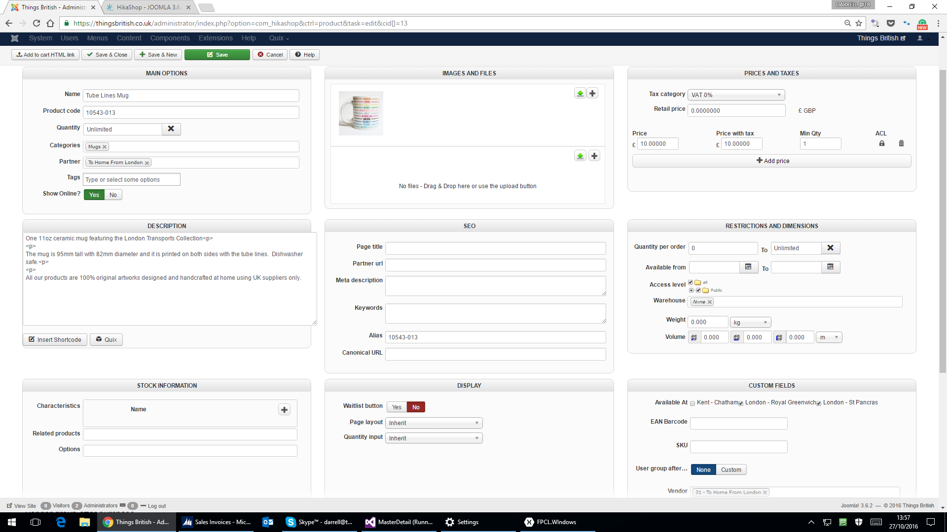

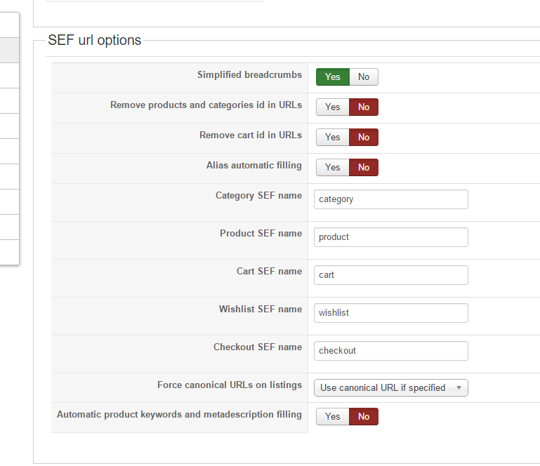

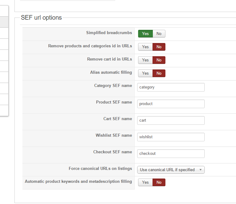

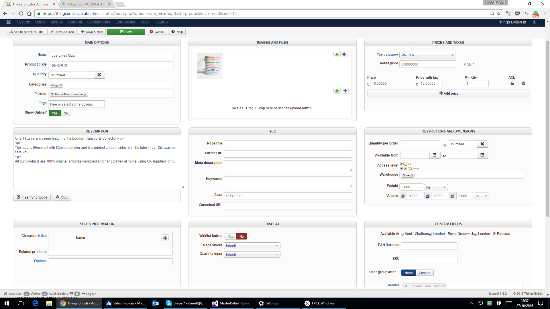

  • Posts: 112
9 years 10 months ago #253719
Sample product, and SEF settings, as requested.
  • Posts: 86083
  • Thank you received: 14194
9 years 10 months ago #253722
Then please provide a backend and a FTP access via our contact form:
because we can't reproduce the problem. Having strange links like that on products listings should not be possible the way you set HikaShop and your product.
So I'm not sure what's going on.
