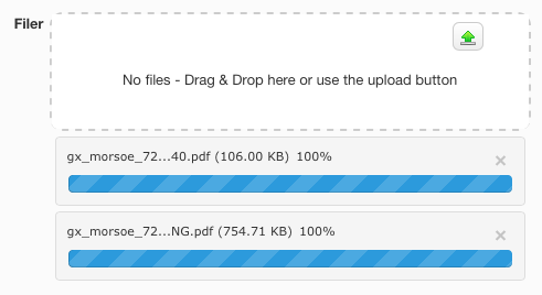

I've created a custom field of type ajax file. Whenever I drop files (pdf) to the ajax file drop area, they never completes (see attached).
The normal "files area" works just fine if I drop the same files in that.
Can you confirm this bug?
EDIT: The file IS uploaded to the media/com_hikashop/upload/safe folder, but upload doesn't complete, so the file is never "registered" with the product.

So I did a test on my end but I didn't get that behavior.
I actually found another bug with custom fields of the type ajax file/image and the table "item" which I fixed and added the patch to the install package on our end.
If your custom field is of that table, then it might help.
Otherwise, it's likely not a bug of the 3.0.0 but simply a problem with the permissions preventing HikaShop from uploading the file or moving it to the destination folder or something.
Try to download the install package on our website again and install it on your website.
Check that the HikaShop's upload folder permissions and the ones of the tmp folder of Joomla and PHP are correct too.
If you still have the problem after that, could you provide a screenshot of the settings of your custom field so that we can try to reproduce the problem in close conditions to what you have ?

I've updated with the latest hikashop available on download. Issue remains.
Please see this video of the issue: dl.dropboxusercontent.com/u/2592749/hika..._ajax_file_issue.mp4

See why we tell you to provide as much information as possible when you post a new thread.
The issue you have only happens with a custom field of the table "product" while we tested with a custom field of the table "item" (the most used one for ajax file/image custom fields). That's why we couldn't reproduce the problem.
Thanks to the settings of the custom field in the video, I could reproduce the problem and fix it. I added the patch to the install package on our end so you can download it again and install it on your website in order to get that fixed.

9 years 7 months ago #261071
Thanks - seems to be working now. It is, however, not possible to link multiple files in the Ajax File field, like with product files?

1 - That's right, the "file" custom field just allow to upload one single file.
Maybe an option will be added in the future to allow multiple file but some restrictions should be added too.
