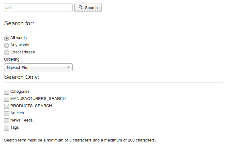

If there is a search error (e.g. try searching for a a term less than 3 characters), the search area strings that should say "Brands" and "Products" instead show as MANUFACTURERS_SEARCH and PRODUCTS_SEARCH. See attached screenshot.

Sorry, to be clearer, the language strings load fine if the search string has no error (i.e. search for a term greater than 3 characters). They shows as MANUFACTURERS_SEARCH and PRODUCTS_SEARCH when there is an error (i.e. search for a term less than 3 characters).

Sure thing. I am able to reproduce this on the HikaShop demo site:
  1. Go to the Joomla Search URL: demo.hikashop.com/index.php/en/?option=com_search&view=search . The search area ("Search Only") names are initially correct here: Brands, Products, Vendors.
  2. In the field up top where it says "Search Keyword", type "ad".
  3. Hit Return or click the magnifying class button. The search area names now show: MANUFACTURERS_SEARCH, PRODUCTS_SEARCH, HIKA_VENDORS.
Please note this is using the core Joomla Search, not the HikaShop Filter. As mentioned, if the search term is 3+ characters (i.e. "headphone"), then this problem does not appear.

Please add the code:
		if(!defined('DS'))
			define('DS', DIRECTORY_SEPARATOR);
		if(!include_once(rtrim(JPATH_ADMINISTRATOR,DS).DS.'components'.DS.'com_hikashop'.DS.'helpers'.DS.'helper.php')) return array();
after the line:
function &onSearchAreas(){
in both the files plugins/search/hikashop_products/hikashop_products.php and plugins/search/hikashop_categories/hikashop_categories.php
That should fix the problem.
We'll add that patch on our end too.

Thanks, it works.
