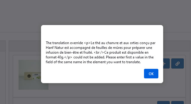

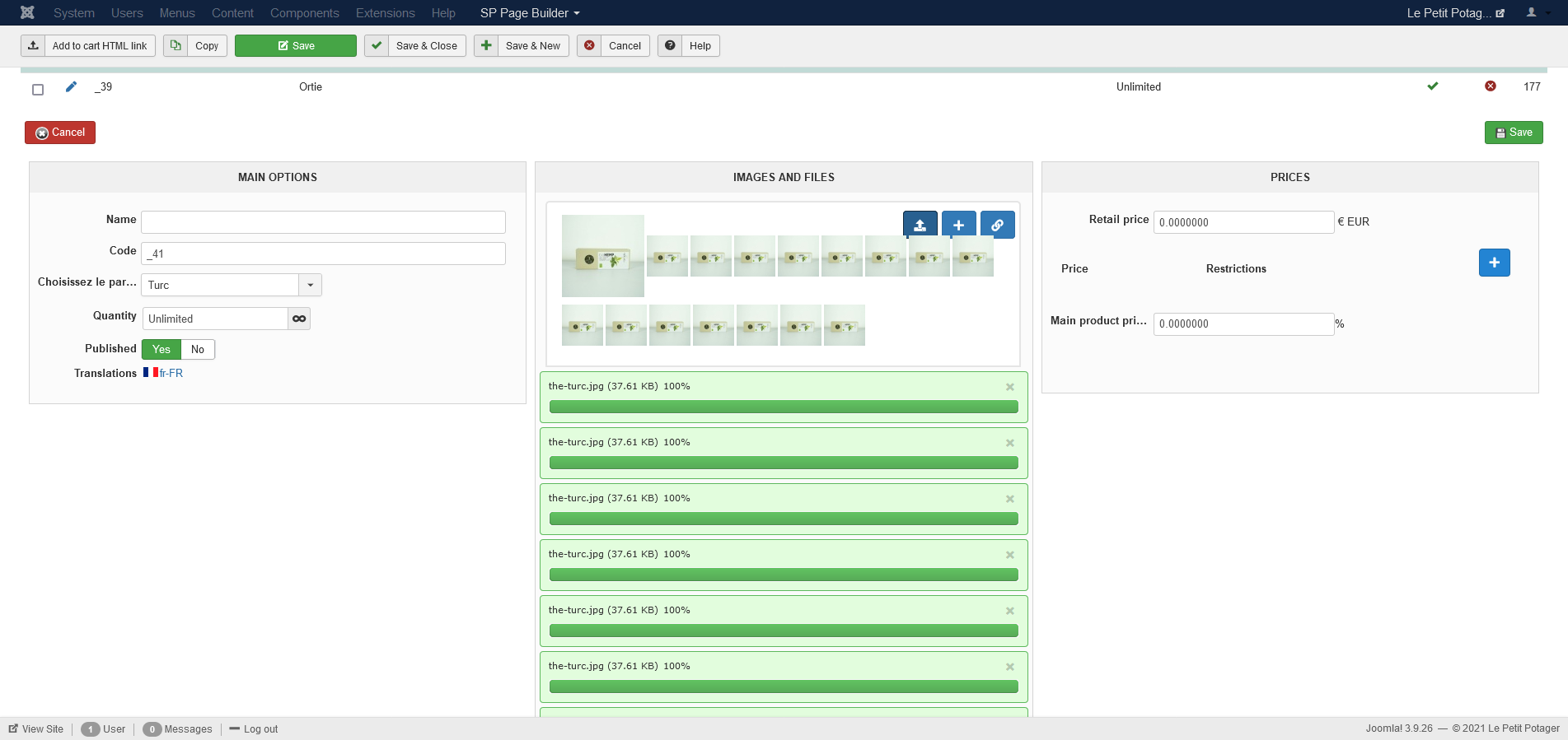

When I upload an image for a variant, it uploads it 10 times without any reason
It happens often that when I add a FR translation, it refuses and displays an error. If I log out and come back, then it works again.

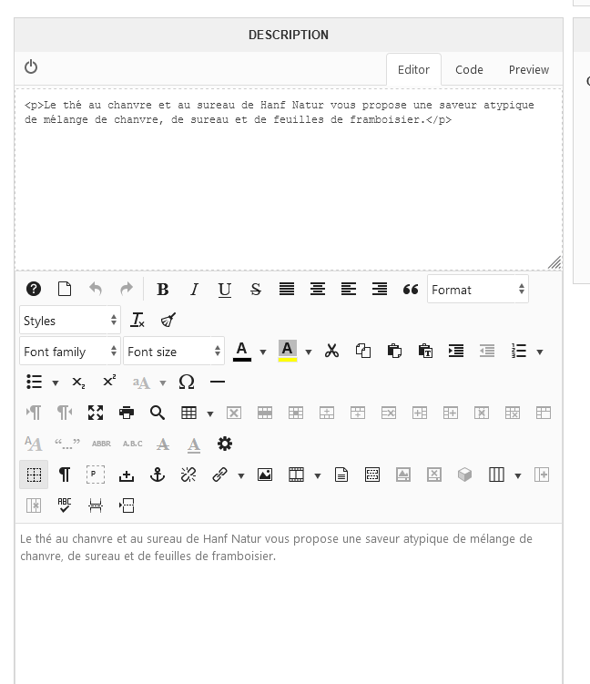

Sometimes, I can't display the code window, it's like it uploads forever. It displays the editor twice, sometimes displays in the editor view the HTML code I entered in the code view.

Regarding the translation error message, it says that you need to first enter the text in the variant description itself before you enter the text in the description field of the translation popup. Did you do that and save the variant at least once before ?
If not, that would explain the error message as the system actually need to use the text from the variant description as key to match it with the translation text in the popup.
Now, what's strange is that I see that you only have French setup on your website (only the French flag appears on your first screenshot). So In that case, there is no need to add any translation since you can just let the system use the text from the description in the variant itself. So I'm thinking that you're having an issue with your HTML editor not displaying for the description of the variant when you edit the variant, and because of that, you thought that you had to use the translation flag to be able to enter the text, which then lead to the error message.
So if my theory is correct, your issue is actually with your HTML editor not loading properly.
In the HikaShop configuration, you'll find under the "advanced" tab a setting "Editor" where you can choose which editor plugin to use in the HikaShop interface. I would recommend to change it to "tinyMCE" the default one of Joomla and it might help. Or even try with "none" to get just a text area. That may help you better understand how the interface is normally supposed to work, when the editor doesn't mess with everything.
Regarding the images upload, I must say I've never seen that. So I'm not sure what's going on. Could you maybe provide a backend access and precise instructions to reproduce the issue so that we could look into it ?

Thanks a lot Nicolas for your answer.
I switched from JCE to TinyMCE, it seems to solve the editor issue.

5 years 3 months ago #332828
Thank you for the access.
I was able to better understand the situation and reproduce the issue with the images upload of variants on my local test website.
It was a changed made a few months ago to help for the support of Joomla 4, which had a side effect here, leading to the javascript from the variant edit form being run several times instead of one time, leading to the duplication of the upload event.
I've added the patch on our end and can confirm it fixes the issue for me.
Download again the install package of HikaShop on our website and install it on yours and it will add the patch for the issue.
Have a nice weekend too !

5 years 3 months ago #332833
Good morning Nicolas,
I downloaded 4.4.2 and installed it but it seems the bug remains. :(
Thanks in advance for your help
Sandra
  • Posts: 86083
  • Thank you received: 14194
5 years 3 months ago #332834
Maybe you need to clear your browser's cache. Please try that.
If that doesn't help, then I don't see why you would still have the problem and we'll need a FTP access to check on the situation further since we don't have the bug anymore on our end.
  • Posts: 195
  • Thank you received: 18
5 years 3 months ago #332836
Stupid me. I should have thought about cleaning the cache correctly. It now works fine.
Thanks a lot Nicolas and enjoy your weekend
