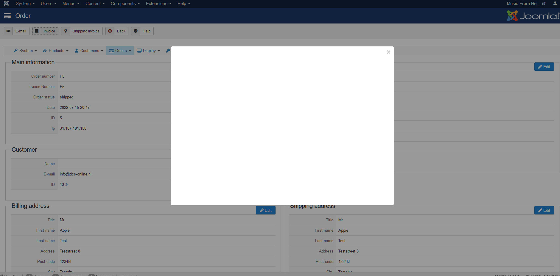

The pdf invoice plugin does nor work on PHP 8.0 and 8,1
I just got a white box were normally is the invoice. not a pop-up with the pdf invoice.
If I change back to PHP7.4 it works as supposed too. Or If I shut down the plugin I am getting the invoice with comes with Hikashop it self

This means you're using an old version of the PDF invoice plugin.
Download its install package on our website via the same link you used when you first downloaded it in order to get the latest version install package. Then, install it on your website via the Joomla extensions installer and it should work fine.

nicolas wrote: Hi,
Nicolas,
Thanks for the quick answer..
I thought something like this already and did look for an update on the site, but tbh it wasn't clear to me if there was an update or not, at least I couldn't fined any reference for it.
Just a suggestion maybe give the plugin a version so we can see if the one we have is outdated, and put it to the subscriptions page for download? I needed to search I long time for the link to it ;)

Yes. Actually, we recently started adding the necessary modifications to our plugins (the ones on the marketplace) to support the update mechanism of Joomla. So normally, now that you've updated the plugin, next time we provide a new version of the plugin you'll get notified by the Joomla update system.
