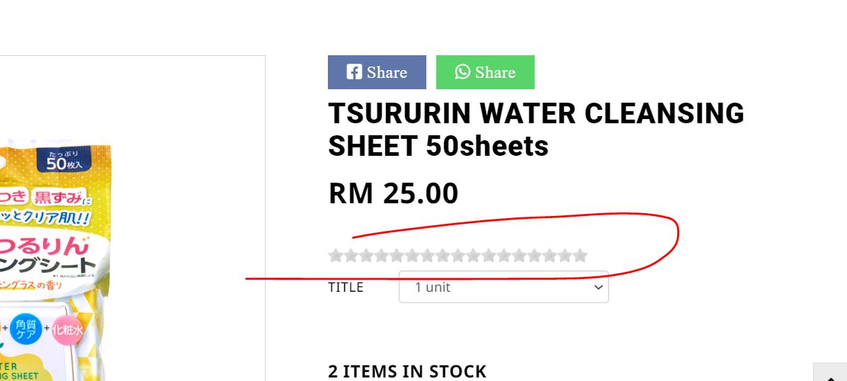

Please help to check this for the vote and comment, the maximum star is set to 5, but end up with got 10 star

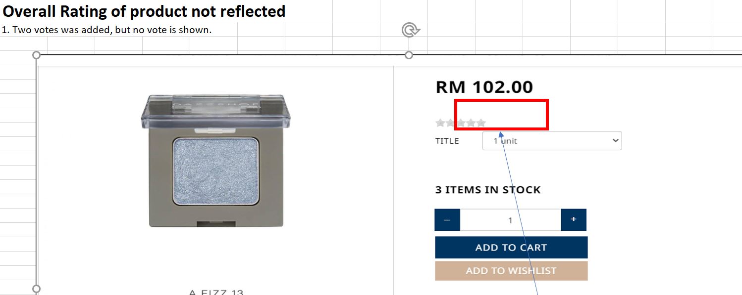

also for this the voting does not reflect on it when there are votes is added

3 years 3 months ago #351659
There were important issues with votes which were fixed in HikaShop 4.4.0.
I would recommend updating to the latest version of HikaShop. Then, post a new vote on that product, and it should sort itself out.

  • Posts: 86083
  • Thank you received: 14194
3 years 3 months ago #351671
I think the most important changes, regarding the vote calculations, were in administrator/components/com_hikashop/classes/vote.php
