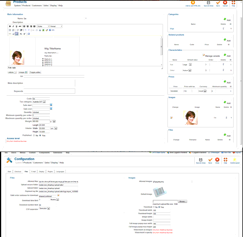

Great product you guys have here! very easy to use :) I will be buying the full commercial version when I get client approval but am just on the starter for now to learn the system..
For some reason my thumbnails on the products are not showing up anymore..
Look Here:
Demo Website
I have attached the relevant (what I think) screens below
Also is there a way to change the VAT as below to GST (for Australia) on the invoices that get sent to customers?
Shipping method : AUD4.55
TOTAL without VAT : AUD59.10
TOTAL with VAT : AUD64.56
Thank you for your help
Kind Regards
Matt

It's just that you set your listing of products to display as a list layout and not a DIV. There is no images displayed for list listing.
You need to go in the menu Display->Content menus and edit the menu 142 and change the type of layout to DIV and you should see them again.
You can override any text in hikashop via the interface in the config under the tab languages:
