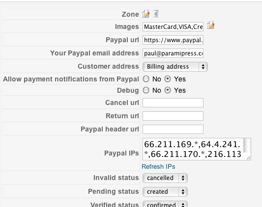

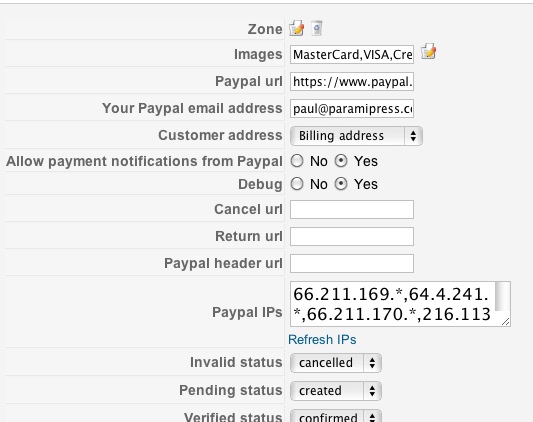

  • Posts: 31
15 years 4 months ago #11575
As you can see in the image, paypal notifications are activated. I received a receipt for payment from paypal. But there was no link to the download.

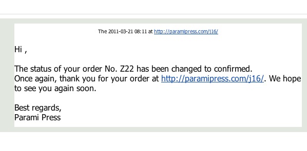

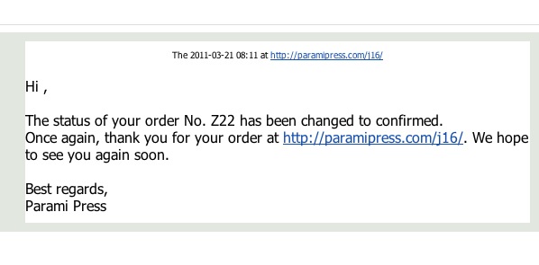

15 years 4 months ago #11583
If this is what you're talking about, you can see there is no link to the order. Any other suggestions on where the look for the problem?
  • Posts: 86050
  • Thank you received: 14178
15 years 4 months ago #11585
That's the email.
I've looked at the email rapidly on our end and the link is not added if you use the "no registration" option. Since orders details and downloads are secured so that only the customer can access his own orders and downloads, hikashop needs to be able to authenticate him. That requires that you use either the normal registration or the simplified registration.
