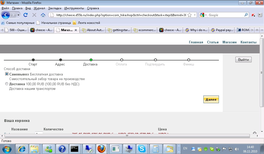

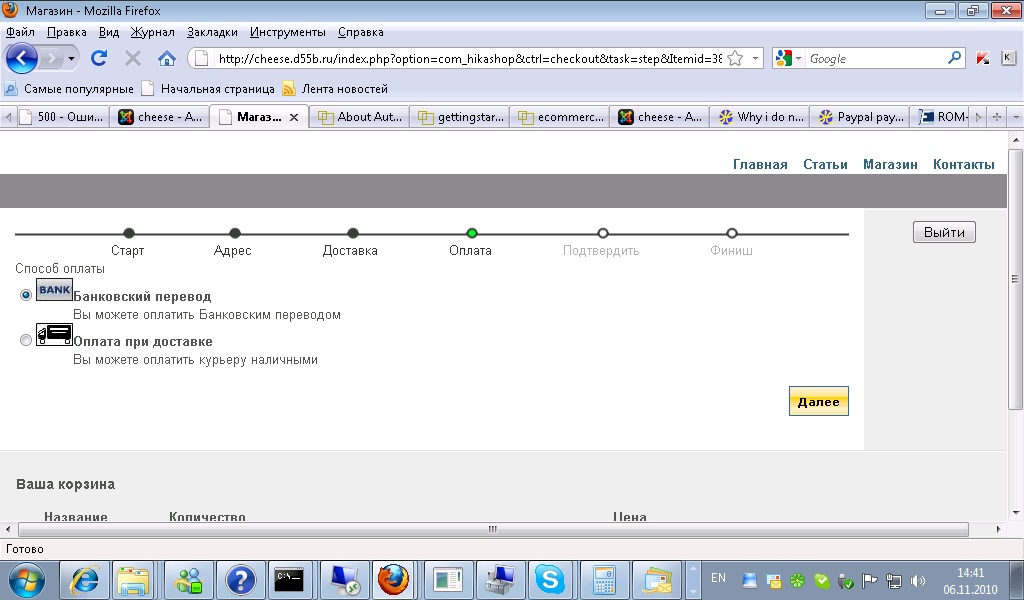

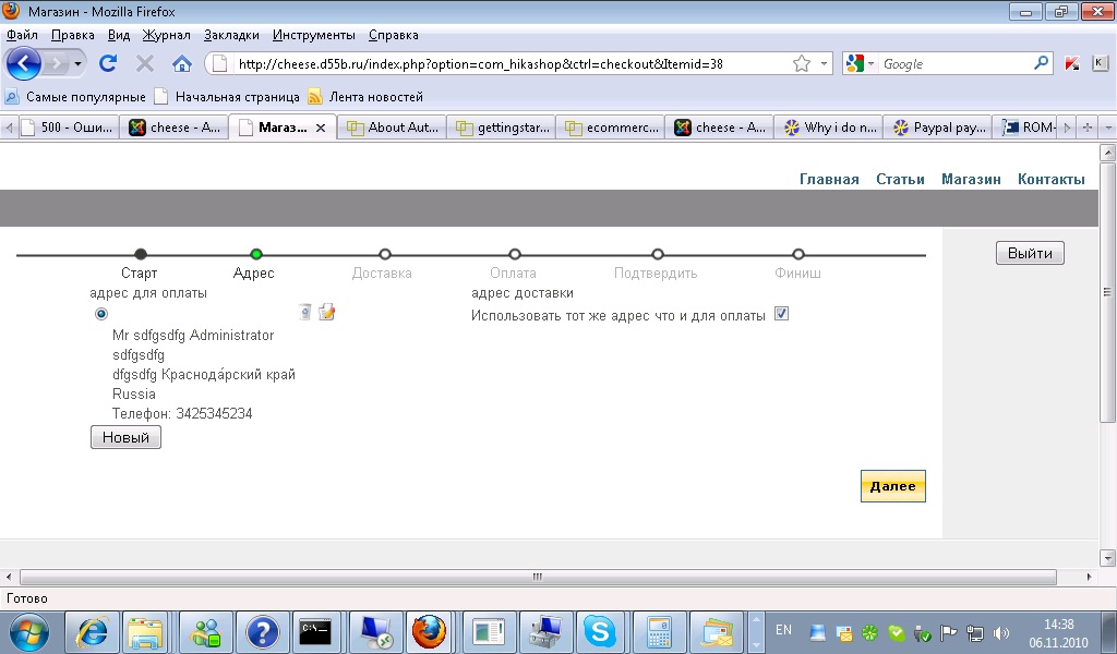

press add to cart and going to processing
pressing next at address page
select free delivery(no matter when select payed delivery),after this press next for pay and
only bank transfer and COD

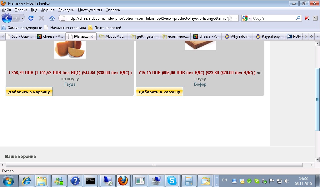

The currency which is used on your front end is RUB not USD (as shown in your first screenshot). Paypal does not handle RUB and that's why you don't see it.
Try to login/logout of your website or try with another browser or display the currency switcher module and set USD and you should see the paypal payment option.
