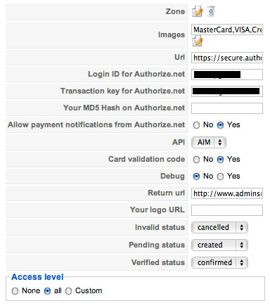

It seems that you're using the AIM API of authorize.net and there is no redirect to authorize.net for it at the end of the checkout. Did you change it ?

If I use the other setting, SIM, it works but it does not load a https URL. We do have an SSL and it is active. I like the SIM better as it allows the "code" from the card to be entered. I attached the settings I have now.

You can activate the SSL with the option "force SSL on checkout" in the config under the tab checkout.

15 years 4 months ago #12229
Thank you, thank you thank you~! I was looking for that force SSL on checkout and didn't see it. I found it and now the store works perfectly. Great store for Joomla! Thank you for your time and your help.
