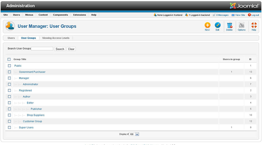

my customer has special pricing for certain users so I made a group for those users (let's call them 'coop'). I have gone through each product and set a price for public and a price for coop. I want that when a coop user is logged in and looking at prices to only see coop pricing, but now they see both listed.
I think what I may need is for my group to not be under "public" tree in usergroup management, but don't know how to do that.
if I don't have a public price it just says FREE. so I need a public price but then also a (lower) coop price. I have checked the config display setting "Price display method cheapest price" and yet it still shows both the public price and the coop price to coop member. I have tried moving the group around but can't seem to get it from under the public.

that is not possible from what I can tell. all user groups are under the public root and cannot have a separate root. so even though I do not tick the public checkbox the coop group is child of public.

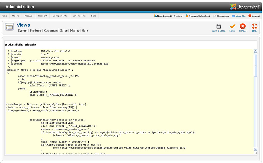

You should be able to do that in the file listing_price of the view product via the menu Display->Views:
$user =& JFactory::getUser();
if($user->id != 62) array_shift($this->row->prices); //supposing that 62 is the id of your coop user

On joomla 1.5, the group id is in $user->gid:
if($user->gid != 62) array_shift($this->row->prices);
For 1.6, it's more complicated as you will get an array of groups:
$userGroups = JAccess::getGroupsByUser($user->id, true);
$inter = array_intersect($userGroups,array(29));//if group 29 is for coop
if(empty($inter)) array_shift($this->row->prices);

ok, when I put this in it works great if the logged in user is in userGroup 13 (my coop group id), but when the person is not logged in it shows no price or add to cart field.
I added it right at the beginning after:
$first=true;
echo JText::_('PRICE_BEGINNING');
and before the foreach
am I not putting it in the right place?
I feel like maybe I need to make that statement an if and have the else be
$inter = array_intersect($userGroups,array(1)); // where 1 is public group
with no array shift? but I keep breaking it and losing the add to cart block.
I REALLY appreciate the help on this. my customer brought this issue up to me again today so I really want to get it right if at all possible (and anything is possible if one knows php well enough? :blink: )
Last edit: 15 years 4 months ago by dontflinch. Reason: typo

Could you post the piece of code you used and a screenshot of the groups listing you have in the back end so that we can see the corresponding ids ?

ok I found how to do it in joomla. I am so sorry to have been a bother!
I edited the user group options to set the guest group to "customer" and had to move the special group back under registered. but now it seems to work as my customer wanted.
