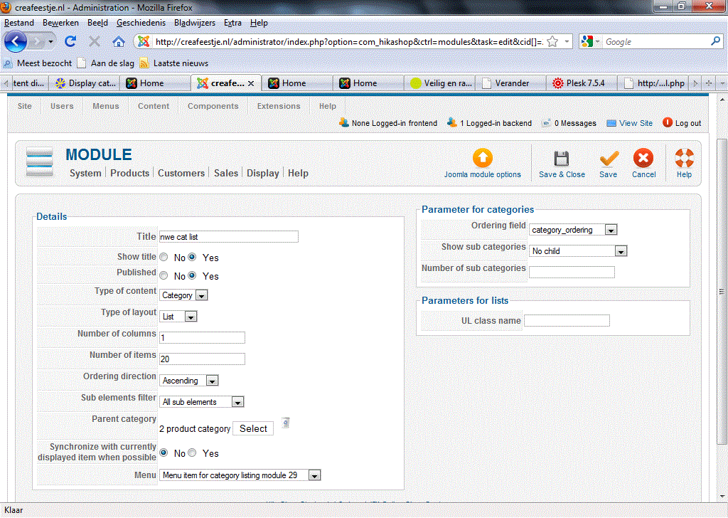

Could you do a screenshot of the hikashop options of your "nwe cat list" module ? Looking at the URLs of the categories, the "menu" parameter is set to none which shouldn't be the case.
  • Posts: 16
15 years 4 months ago #12546
Pls see the attachment
  • Posts: 86045
  • Thank you received: 14176
15 years 4 months ago #12553
That sounds good. Could you give a back end access to your website so that we can check the other parameters ?
