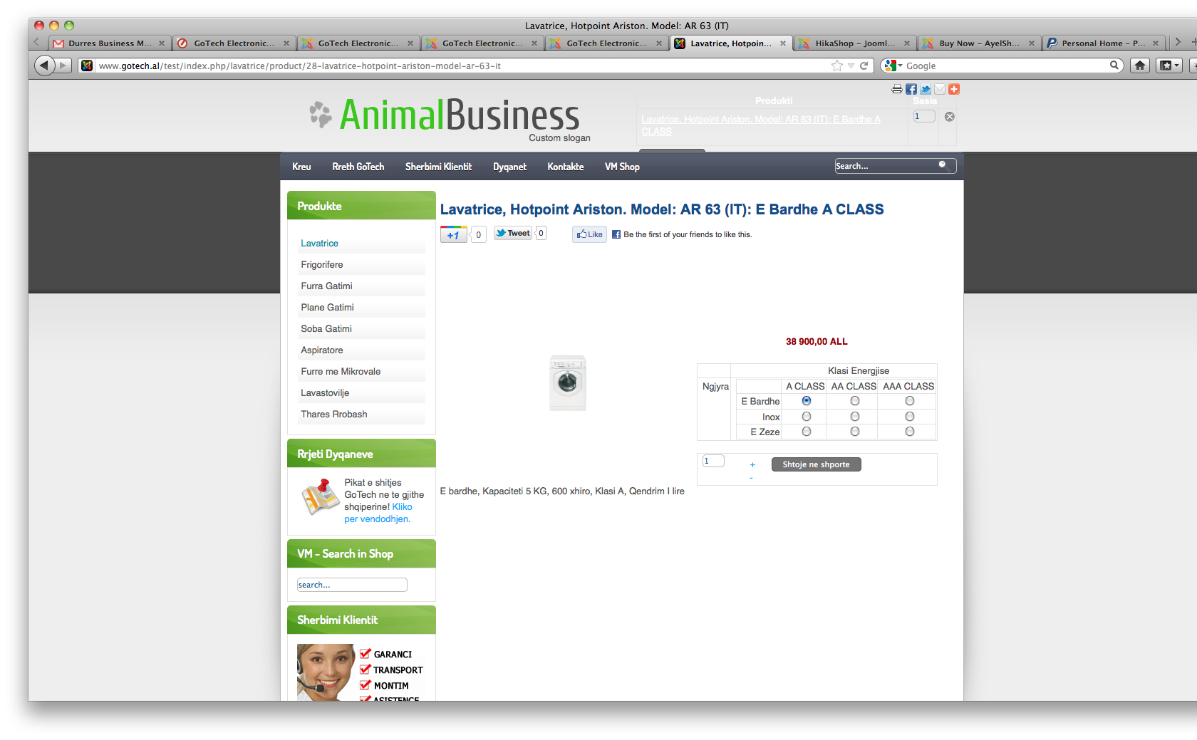

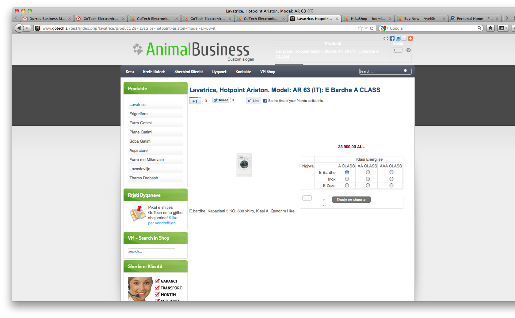

  • Posts: 14
14 years 6 months ago #36297
i did used the minicart, but when i add a product, it shows me full cart. when i navigate away from this product than i see only total ammount.

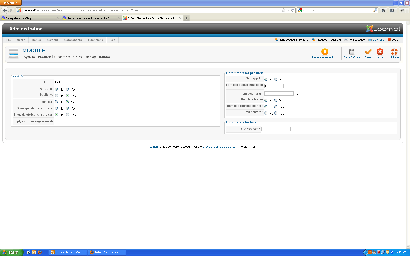

  • Posts: 86042
  • Thank you received: 14175
14 years 6 months ago #36399
Could you do a screenshot of your cart module's hikashop options screen ?
  • Posts: 14
14 years 6 months ago #36422
have i attached correctly??

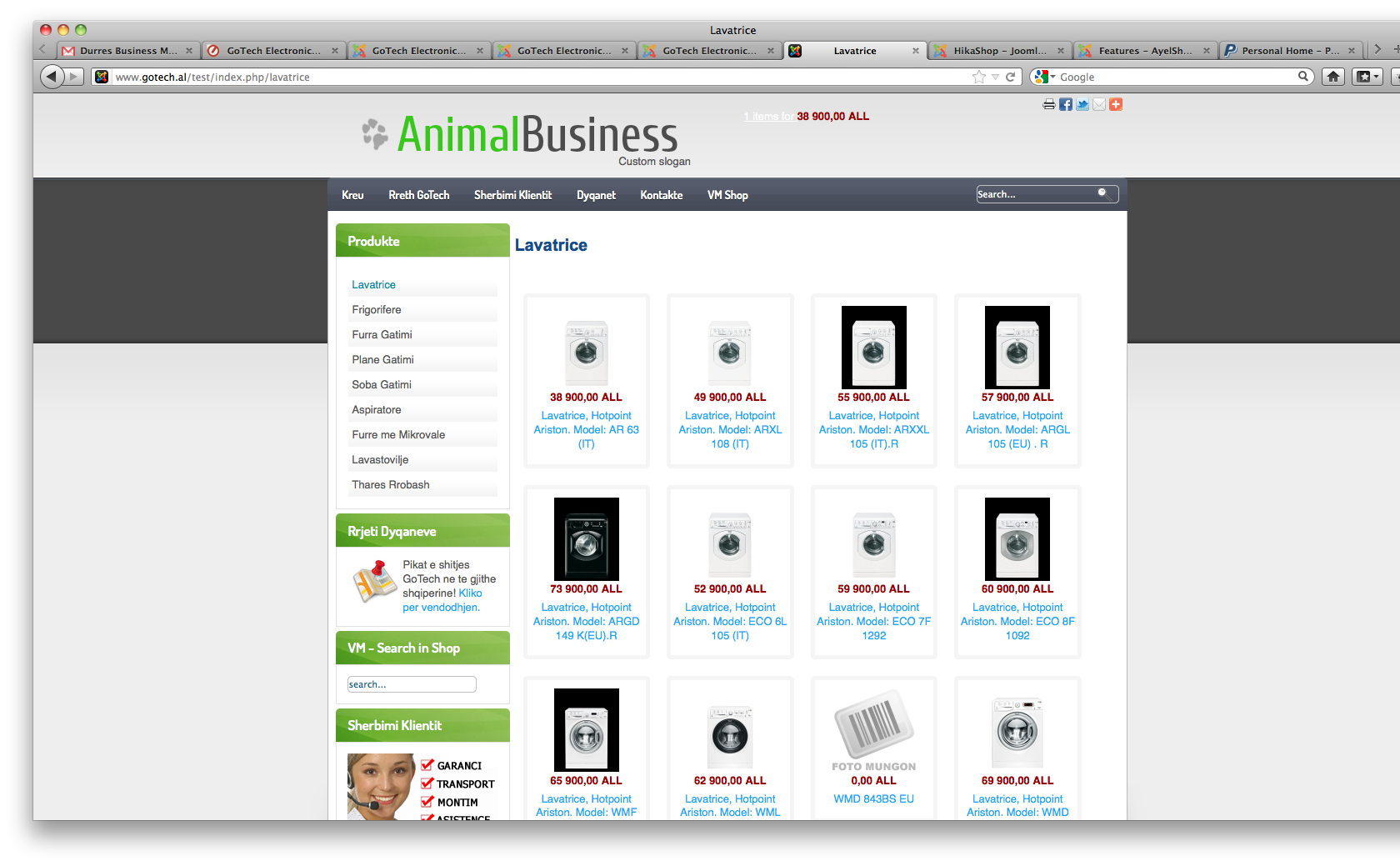

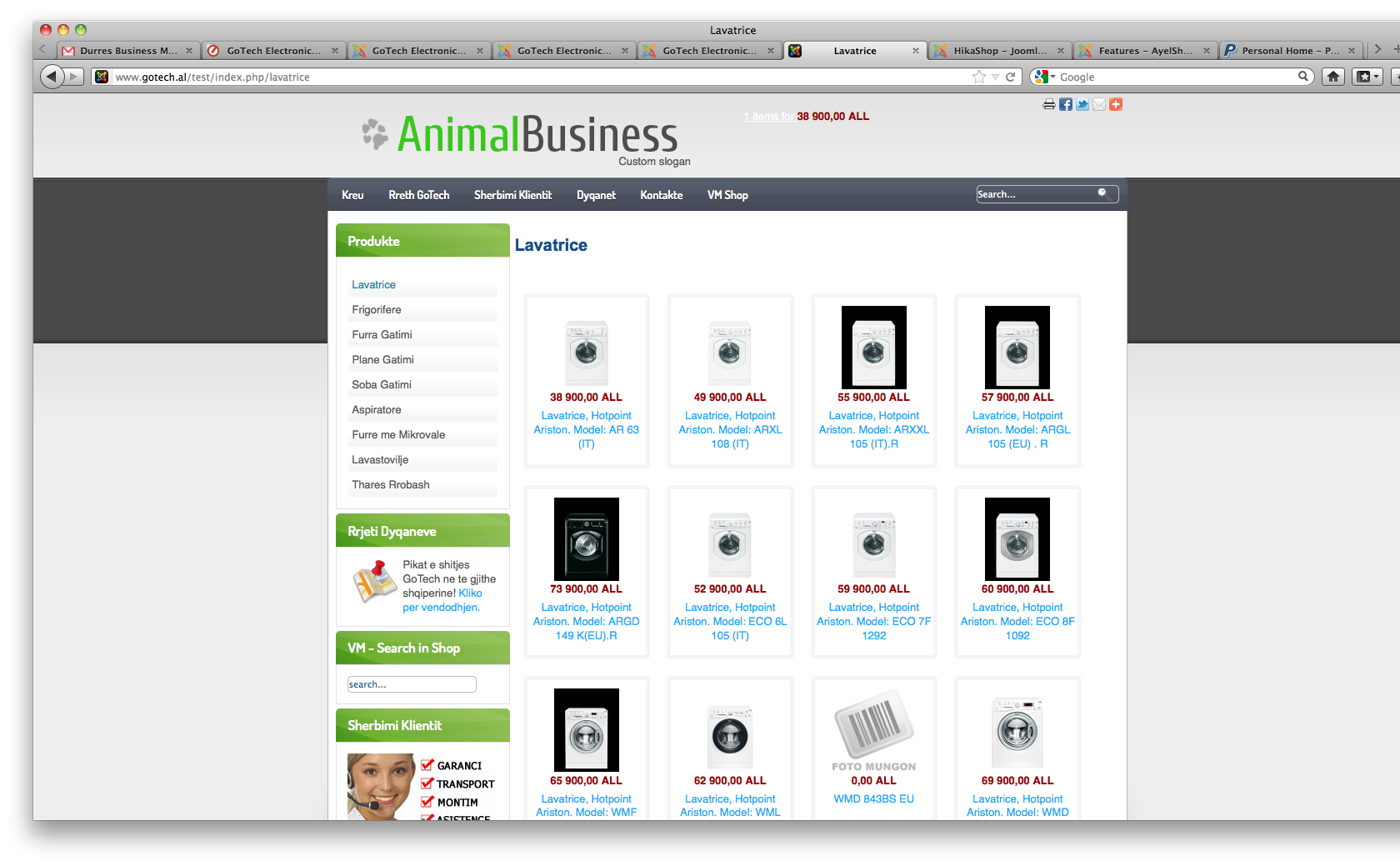

  • Posts: 14
14 years 6 months ago #36424
this is the screen after i navigate away

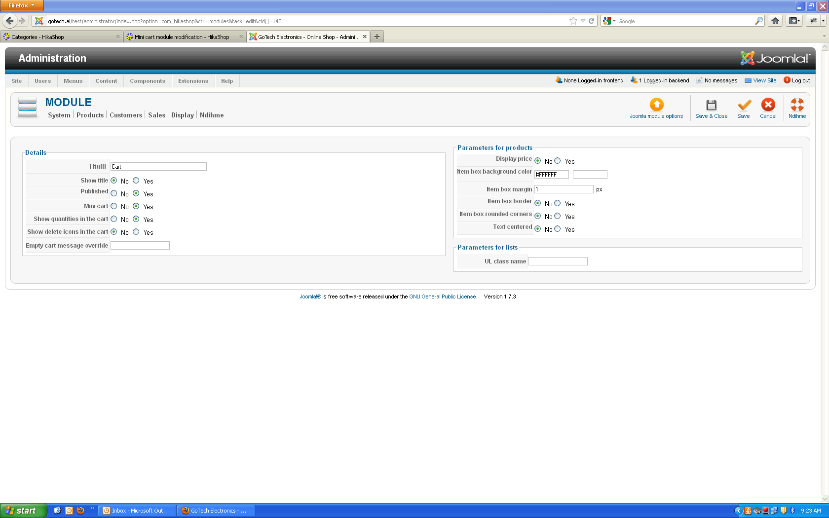

  • Posts: 86042
14 years 6 months ago #36456
No, I'm talking about a screenshot of the options of the cart module, not the front end of your shop.

  • Posts: 14
14 years 6 months ago #36483
i found out something that may help. When i click add to cart, i see the pop up asking pay now or turn to the shop. when i say pay now, the page is going to different url and during this process the page is refreshed and minicart is displayed correctly. when i say turn to the shop page is not refreshed and i see big cart.
