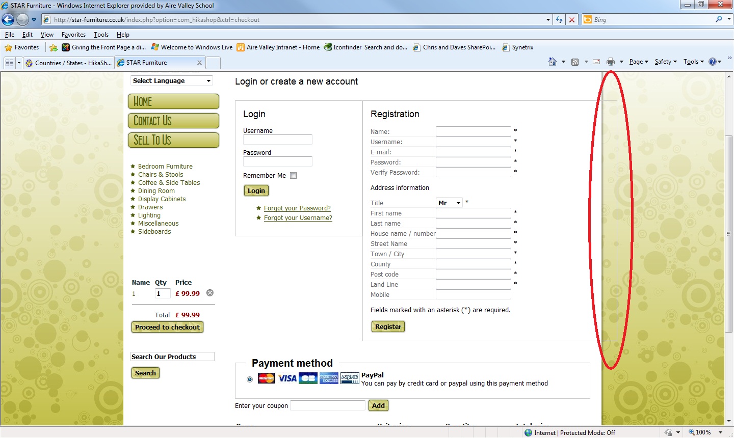

I thought i`d better start a new thread for this. I`ve only just noticed and i think it might be something to do with the 'State' drop down box, but the boarder of the registration page goes off the right hand side edge of the template, this might be fixable when i can edit the zones.:
  • Posts: 86096
  • Thank you received: 14200
15 years 10 months ago #130
Yes, if you unpublish the countries and states with the longest names the dropdowns will shrink in size. You can also rename the longest one.
However, the size of the fieldset is locked in the CSS. So after reducing the dropdowns size, you will have to edit the front end CSS of hikashop via the interface provided in the configuration page under the tab display and reduce the width option of the CSS class hikashop_checkout_login_right_part (near line 175 of the file).

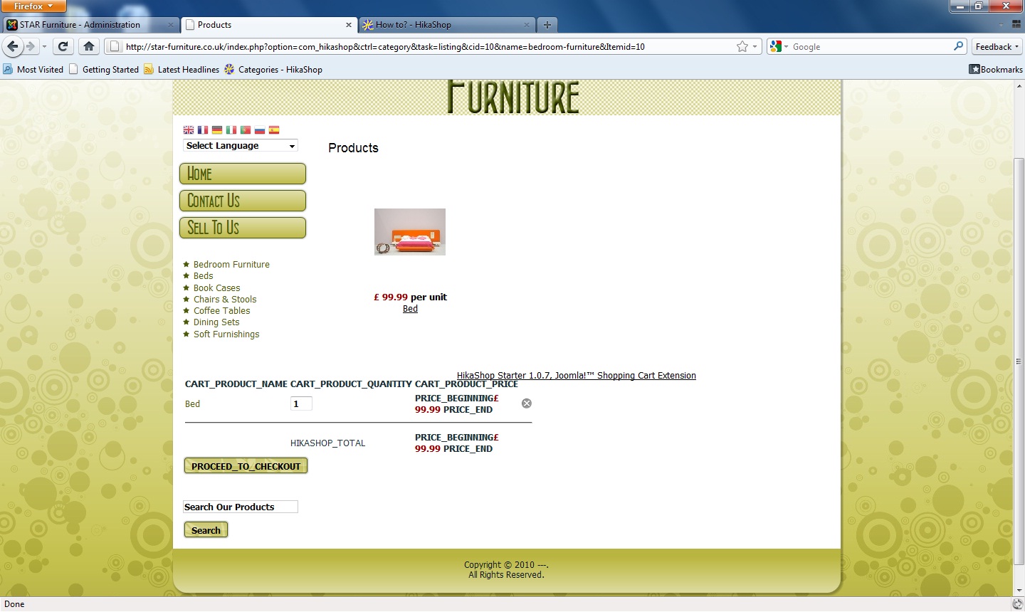

A new issue with cart spilling out onto main page. Add an item to cart, continue browsing another category and:
Also, how come there is an underscore between each letter, for_example_like_this
Last edit: 15 years 10 months ago by manamaga.
  • Posts: 86096
15 years 10 months ago #187
That problem happens when the translations can't be found. Usually that should not happen but for a strange reason, it happens on your website. Anyway, thanks to the FTP account you provided me earlier this week, I was able to find a solution and fixed it on your website. The modification will be added to the next release as well.

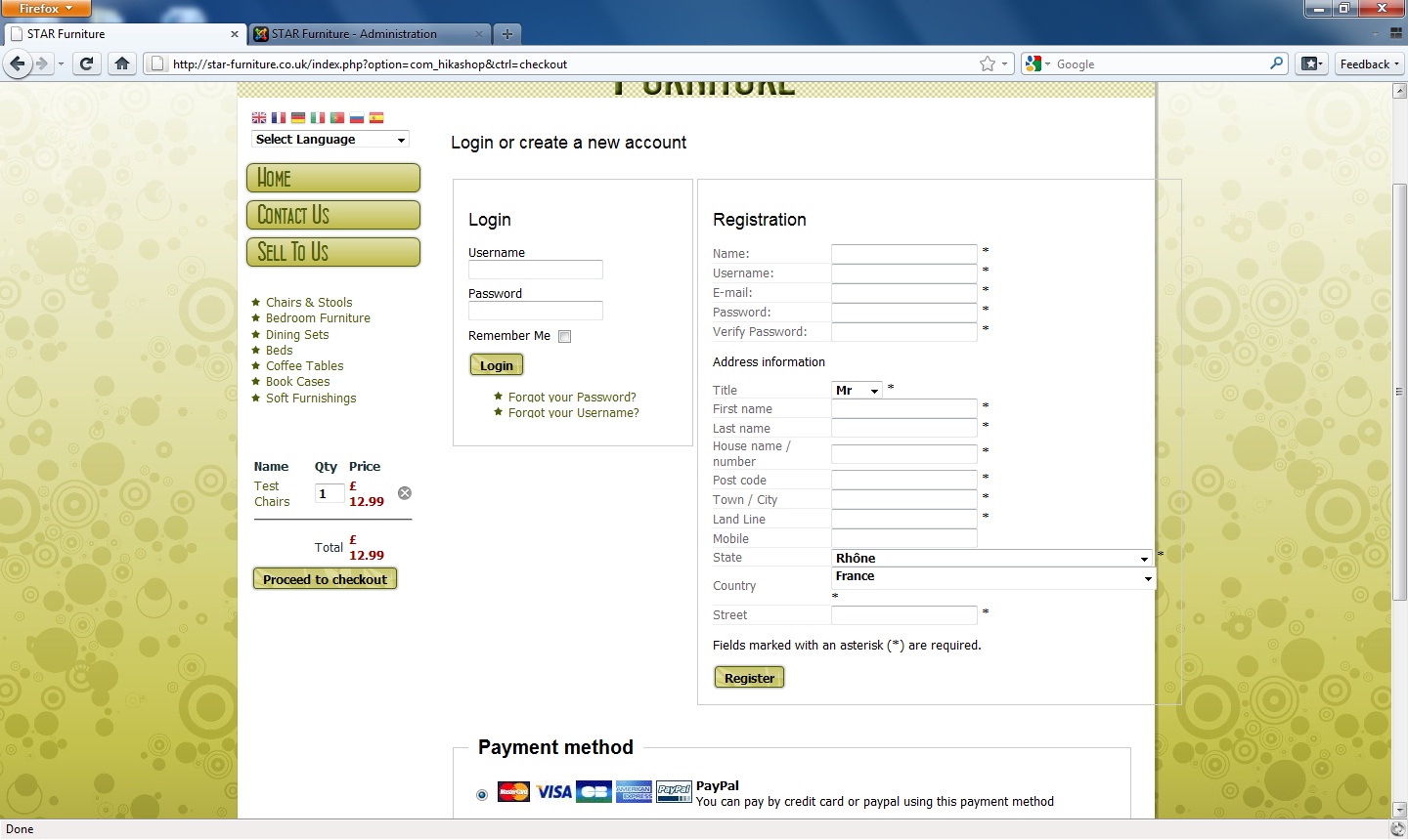

Back to the original problem of this thread, the width, i have removed the country drop down box, as most, if not all, of my clients business will be in the UK, but the width still rides over:
  • Posts: 86096
15 years 10 months ago #351
Yes, it's normal. Let me quote you the end of my message above:
"the size of the fieldset is locked in the CSS. So after reducing the dropdowns size, you will have to edit the front end CSS of hikashop via the interface provided in the configuration page under the tab display and reduce the width option of the CSS class hikashop_checkout_login_right_part (near line 175 of the file)."

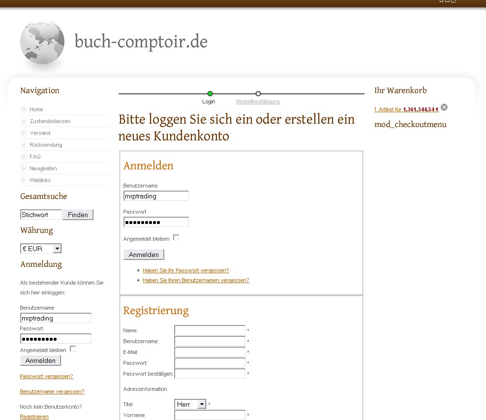

  • Posts: 31
15 years 5 months ago #10316
thanks a lot both of you. I had a similar width problem, and now hope to having fixed it this way - below changes in red in file "//media/com_hikashop/css/frontend_default.css":
/* checkout login layout */
.hikashop_checkout_login{
clear:both;
width:100%;
margin:auto;
.hikashop_checkout_login_left_part{
width:100%;
float:left;
.hikashop_checkout_login_right_part{
width:100%;
float:left;
As a consequence, the two boxes are now listed one after each other, not side by side anymore, thus I can fill the right column now as intended in the template I use.
Don't know if it works for you readers, however maybe it is of some help.
Regards, M. B)
www.buch-comptoir.de
shop.buch-comptoir.de
[Weltweiter Versand seltener Bücher]
