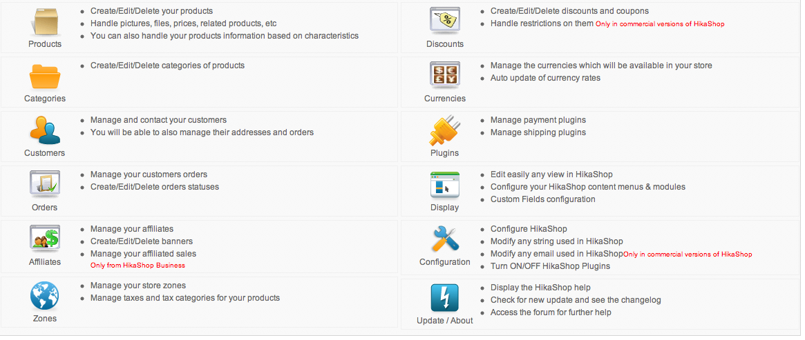

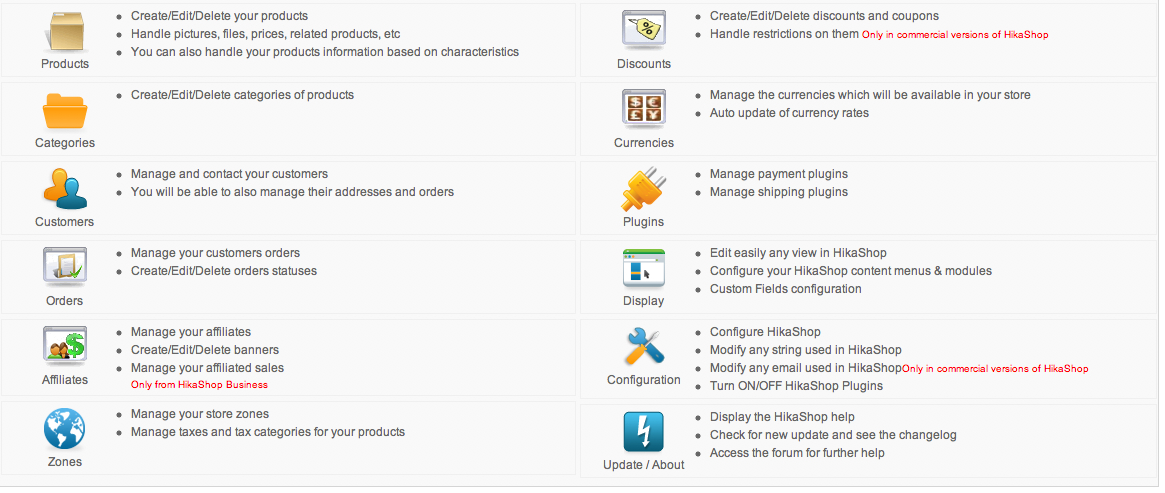

Could you do a screenshot ?
  • Posts: 131
  • Thank you received: 7
15 years 4 months ago #12741
No, I don't see that menu.
Screenshots linked.
