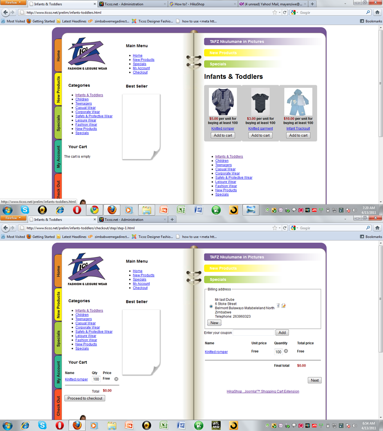

I am using the free version of the Hikashop and I have to say this component has been by far the easiest to set up configure and deploy. However, I have been boggled by how the cart and checkout list the product prices as FREE while these prices have been set in the background and do appear in the shop front/catalogue correctly. But when the products are added to Cart they are listed FREE?
Also, I would prefer to allow the users to continue shopping and checkout at the end, but here it seems immediately on "Add to Cart" it goes to checkout?

I have solved this by pricing in Euros
In that case I move to suggest to the developers to allow products to be listed wholly in USD without the need to include the EUR equivalent. It looks like EUR is the preferred Hikashop currency where as some of us might prefer other currencies. I am aware that the free version does not have an automatic currency conversion so allowing us to choose one and stick to it would be great and much appreciated

You need to set the option "main currency" of the configuration to USD. Otherwise, the default currency on the front end is EUR. And in that case, if you don't set a price in EUR, it will use the USD price converted to EUR if the USD currency is published.
You can manage your currencies via the menu System->Currencies.
HikaShop handles currency conversion. There is also a currency switcher module available.
