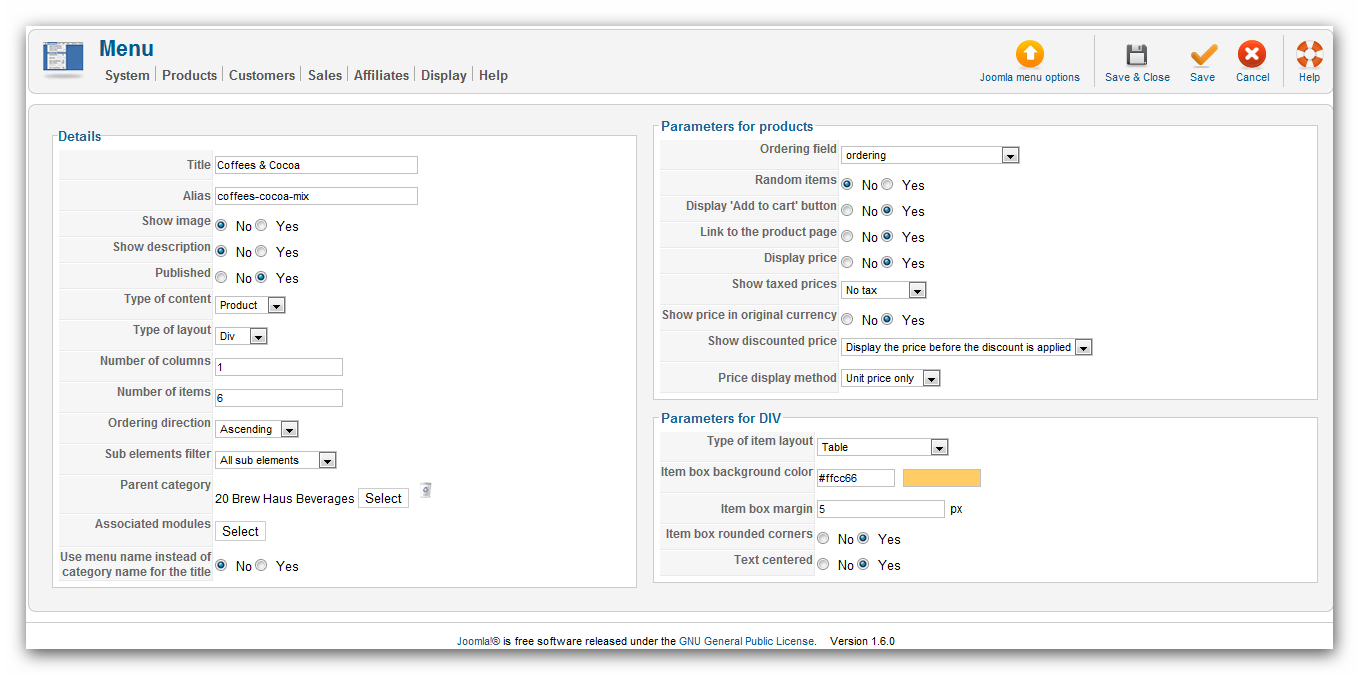

Could you go to Display->Content menus and edit the menu with the id 121 and make a screenshot of the options there ?
  • Posts: 22
15 years 3 months ago #14280
Here's what it looks like:
  • Posts: 86045
  • Thank you received: 14176
15 years 3 months ago #14286
You have the "type of layout" option of you menu to "DIV" and the "type of item layout" option of your menu to "table" which is not possible. If you want to use a table layout for your products, you should set the option "type of layout" to "table" instead of "div".

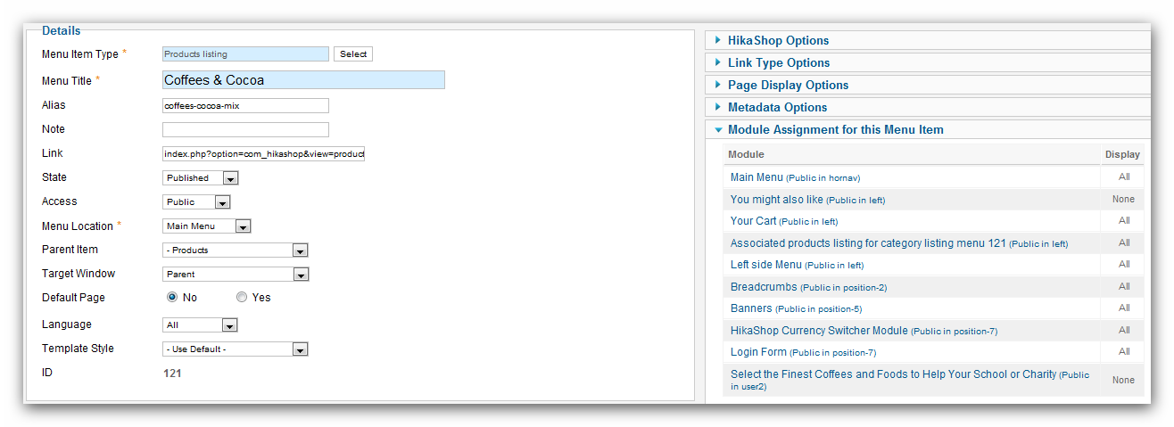

Thanks, Nicolas! That fixed the multiple issue - except for having the "Select the Finest Coffees and Foods to Help Your School or Charity" module appearing on that page - after the products of the category. In the attachment you can see that I have that module assignment set to 'none'. The module is supposed to only appear on the home page.
  • Posts: 86045
15 years 3 months ago #14299
That's because you have that module published in the "associated modules" option of your menu. If you unpublish it from there, it won't display on that page.
