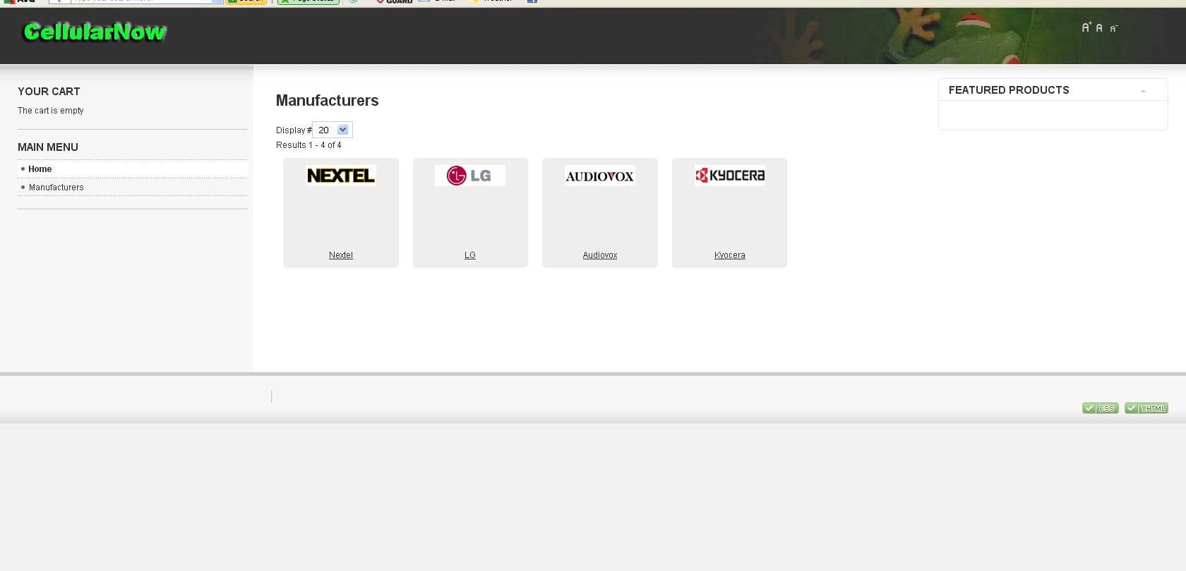

When i click on manufacturers under the Main Menu.. i want to be able to go to the same page as if i click on manufacturers in the content area(the sanyo logo). Hope this is clear. Thanks

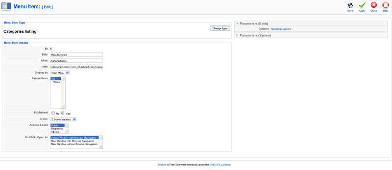

When editing each menu items, you need to click on the "HikaShop otions" link on the right part of the screen where you will be able to set the "parent category" to the manufacturer name and then save the options. That should do it.

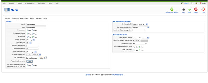

Here are two images: i see the options in pic1 i clikk it it goes to page pic2 then i dont see anything to link to the page i want.
  • Posts: 25
15 years 9 months ago #1480
Here is pic2

On pic2, please click on the select button of the option "parent category" in order to choose the category you want to be displayed. And also, if you use the type "category", you need to add an associated module which will display the products. Otherwise, please use the "product" type in order to directly display the product listing upon clicking on the menu.

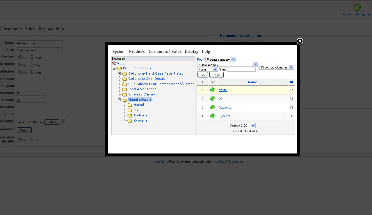

I go this pop up but there is nothing i can do here. I want manufacturers link to go to the main page where there are all the different manufacs.

When I click manufacturers link on main menu I want to to this page. I cant find this page to link.

In this popup, click on "product categories", then, on the listing of the right, you will see the "manufacturers" category listed. Click on the plus icon of the row and then save the options.

I can select only 1 item. I gave 5 stars on the forum but i dont think it can work when you have sub categories. Your response is excellent but I have been trying for 2 days to figure this out with no luck. When i click on my manufacturer link it goes to one specific manufacturer not the group of manufacturers which is what i want.

That's because you are using a joomla menu module. You will have to do that for each menu: select its own parent category.
Otherwise, you could create a new category listing module which would display all the manufacturer categories automatically and set it to display the products.
