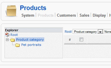

How do I set up HS to have a menu item that takes me straight to a list of products all on one page. I only have 8 products to list. Currently there's an intermediate page which is a list of the categories (only 1 of them). I want to skip this page.
See the image for the product tree.

  • Posts: 86048
  • Thank you received: 14176
15 years 3 months ago #15014
So you need to create a new menu item via the joomla menu manager of the type "hikashop product listing". Then, in the hikashop options of that menu item, you need to change the "sub element filter" option to "all sub elements". You can access the hikashop options of your menu via the link on the right of the screen when you edit your menu item or via the menu Display->Content menus in HikaShop.
