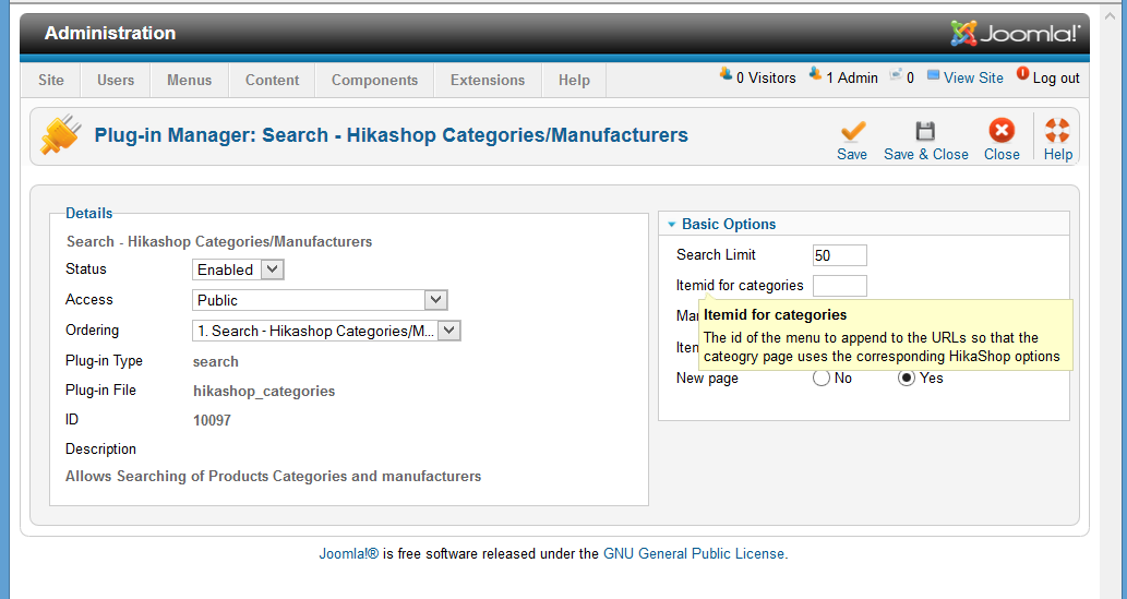

I see this solutaion for obtaining the itemid has been removed in version 1.5.3. This now results in blank pages when the user searches for a category and clicks to display the category. In the category search plugin we have not set the Itemid because our menu structure is:
Home
Category1 > Subcategory1 > AnotherSubcategory1
Category2 > Subcategory2 > AnotherSubcategory2
Category3 > Subcategory3 > AnotherSubcategory3
Category4 > Subcategory4 > AnotherSubcategory4
So you can we don't have single itemid that satisfies the setting for each view. The solution in these posts worked well. I presume when the the manufacture option was added it was removed for some reason. (edit - sorry, getting confused. This was implemented for the product search - now I am going see if something similar can be implemented to get the itemid if the itemid is not set in the category plugin.)
Last edit: 14 years 5 months ago by jameswadsworth.

Indeed. That was never implemented for the categories search plugin.
