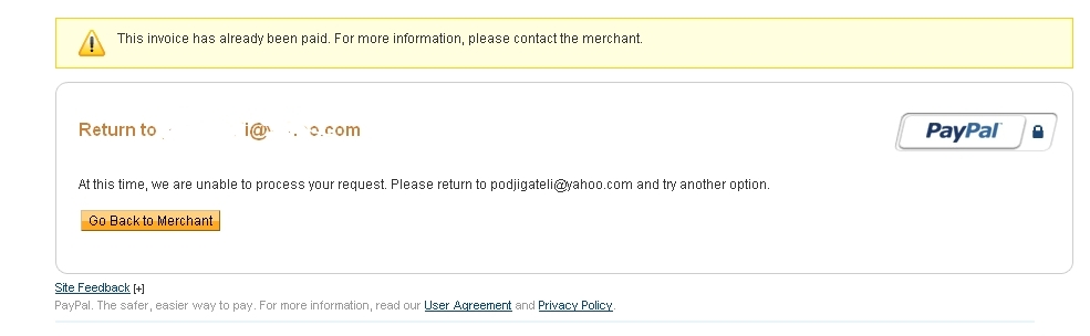

Thanks. What that means? This invoice has already been paid. For more information, please contact the merchant.
At this time, we are unable to process your request. Please return to @yahoo.com and try another option.
when I returned to my site there was a blank(nothing).

It is possible for Paypal to report an order as already being paid if they have received an identical invoice number in the past. There are a couple ways to resolve this issue:
In Your Paypal Account:
Login to your Paypal account by going to www.paypal.com .
Click "Profile" on the top menu bar.
Under "Selling Preferences", click "Payment Receiving Preferences".
Under "Block Accidental Payments", choose "No, allow multiple payments per invoice ID".
On the HikaShop side:
Open your phpmyadmin and select your database.
There increase the auto_increment value of the hikashop_order table by running a query: www.cxliv.org/2005/01/06/updating_auto-increment_in_mysql.php

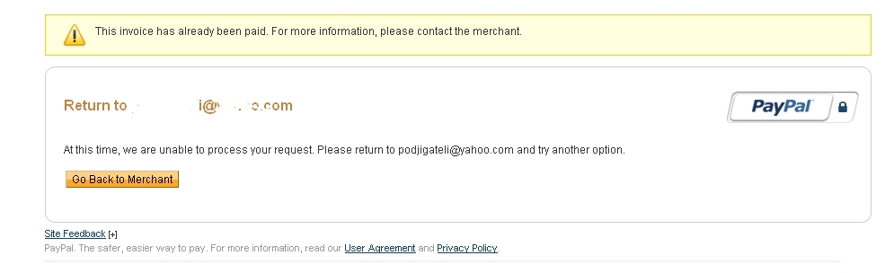

I keep getting the "This invoice has already been paid. For more information, please contact the merchant." I'm testing using the paypal sandbox. I have tried the suggestions repeated below:
Any further thoughts or info I can provide to help?
Chris

What is the query you run on your phpmyadmin?
  • Posts: 50
15 years 3 months ago #15734
ALTER TABLE jos_hikashop_order AUTO_INCREMENT = 2023
Thanks:)
  • Posts: 86048
  • Thank you received: 14177
15 years 3 months ago #15750
Maybe the auto_increment is not high enough ?
Also, that will only work for NEW orders, not for existing ones.
