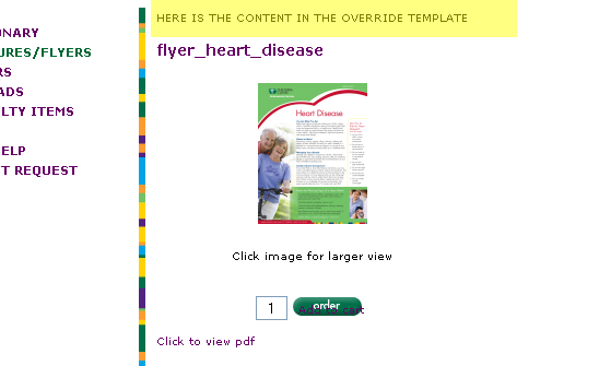

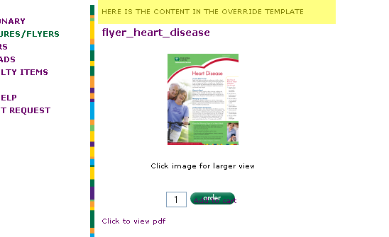

  • Posts: 6
15 years 3 months ago #16977
Well I assure you it is in the right folder, when i add plain text to the file it shows up above the product detail - see the attached. So your code isnt working.
  • Posts: 86179
  • Thank you received: 14214
15 years 3 months ago #16982
Could you send us an FTP access and back end access to your website so that we can check on the problem ?
