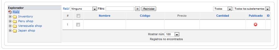

As a result, now all those testing products has dissappeared from searching results, but now i got an empty product in my backend with a curious behaviour: i can´t delete it and if i try to edit it, a new product is created with those new settings and this blank products remains.
I guess that i need to delete something more, but i do not know what.
Last edit: 15 years 6 months ago by Avaray.

15 years 6 months ago #1577
It's easy to find the culprit. Select the product and click on the edit button. On the edit page of the ghost product, if you put your mouse over the title "Products" you should see in the URL displayed at the bottom of your browser the id of that product. Then, you just have to search for that id in the product table and remove it.

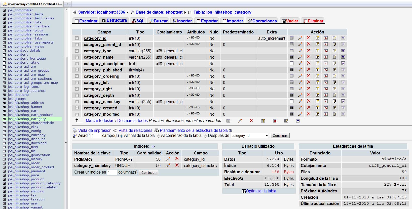

Sorry, but there is nothing related to products in "hikashop_category".
The only two options related to id are "category_id" and "category_parent_id".
The only one with an entry marked with id=0 it´s "category_parent_id".

  • Posts: 59
15 years 6 months ago #1582
There was only a product there, but despite the url link said that id=0, this product had id´s different from 0. After deleting it, ghost product has been erased. I am not sure about what happened, but now the ghost one it´s gone.
