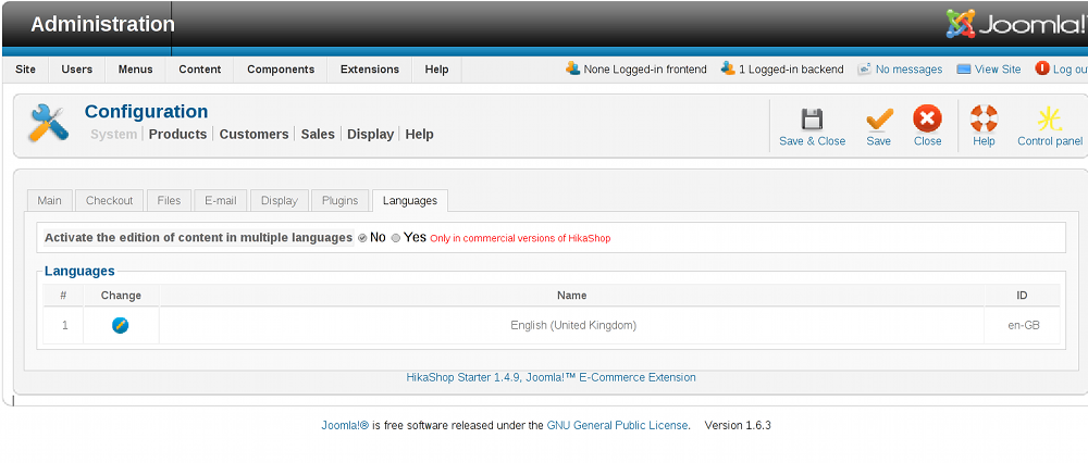

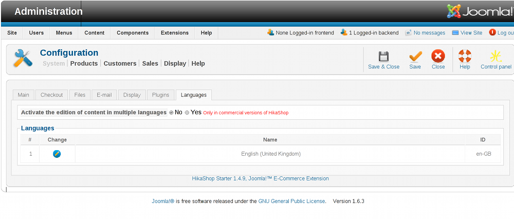

  • Posts: 4
15 years 3 months ago #15661
Sorry but I must miss something.. :dry:
I joined a picture.
  • Posts: 86048
  • Thank you received: 14177
15 years 3 months ago #15662
There is a "change" icon for your translation file on that screen on which you can click to, well, change it...
