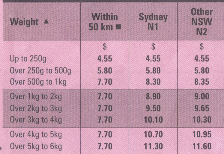

I compared the standard postage calculated by HikaShop with the rate sheet from AusPost and noticed the postage rates HikaShop calculates are not correct. A package weighing 300g should ship anywhere in Australia on the standard service for $5.80 including the 10% GST but Hikashop calculates it as $5.23 including GST which I think was the rate pre-June 2010. Is HikaShop pointing at the right place at AusPost?

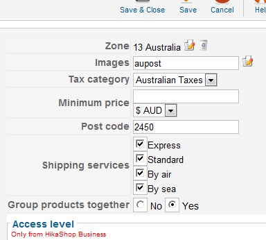

Could you do a screenshot of the configuration of your Auspost plugin ?
The rates are asked dynamically to the auspost server each time so if the rate is not good, it's either a configuration problem, or a bug in the plugin or auspost which doesn't return the good rates.

Please see below a screenshot of the AusPost config. I have also attached a section of the AusPost rate card so that you can see the current rates. I have a cart on another site that uses AusPost website for prices and they are working fine so looks like it is OK from their end.

Could you try to remove the tax category of the settings ?
When you set a tax category on the australia post plugin, it will add the taxes to the rates sent back by australia post. But if australia post already include the taxes in the prices, then, you have twice the taxes applied on the prices. It can be useful when you want to add a fee to the prices but I think it should not be set if you want the same prices as the prices sheet of australia post.

I checked the AusPost website for the rates and the rates have changed since the rate card I posted above but the postage has increased so a parcel weighing 300g (between 250g and 500g) should cost $6.05 ($5.50 + $0.55 = $6.05). However HikaShop still calculates the standard postage as $5.23 ($4.75 + $0.48 = $5.23) which is not correct. I have the weight of the item set to 395g which is in the 250g - 500g range.

It's actually a setting problem.
The main weight is in kg (the first one in the config option of weight unit) but all the products weight are in g and hikashop automatically converts the weights to the main weight unit before the weight calculations and the weight is cast as an int. So 600g is 0.6kg and casting it as an int makes it 0. Thus only the base prices are taken.
If you swap the weight unit option from kg,g to g,kg in the config, it will pick the correct prices.
